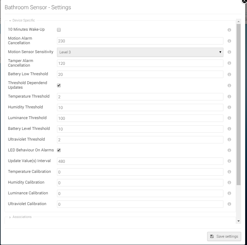

Here is my sensor settings do you see anything wrong with this i was never sure on what the recommended settings are for this device is this very different from anyone elses ? there is also the Wake-up Interval set to 600 seconds
