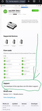

Dali is a community app, but it’s not supported:

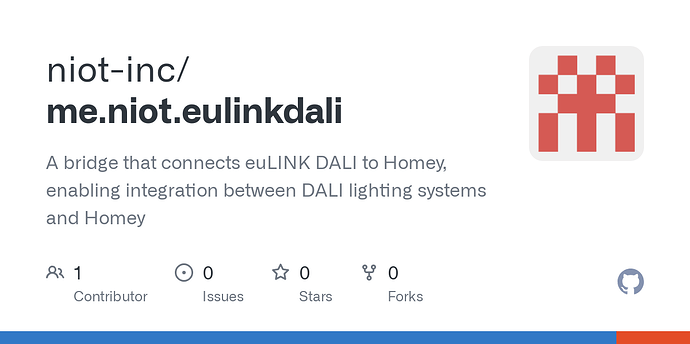

I found a Dali app @ github though, I can’t tell if it’s a different one:
To install, use the forum search tool with the phrase “how to cli”.

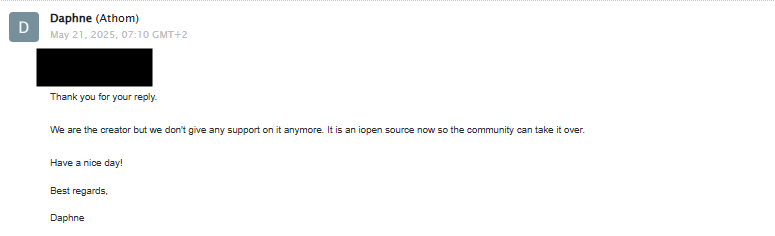

That’s actually the core of my frustration. When I contacted Athom support about an issue, they told me they no longer provide official support for it, claiming it’s essentially “handed over to the community.”
It’s pretty annoying to hear that, especially when their own app listing names Athom B.V. as the developer and it is an “offical” app. It makes their stance on not supporting it quite confusing.
I’ve actually got the whole support conversation attached here, and this experience is making me question Homey’s support for their own products.
If this is how Athom treats support for its “official” apps, I would strongly advise anyone considering Homey to look elsewhere if they expect accountability and dependable support.

Also, even though the source is available, there’s no mention of any Open Source license, which basically means it’s not Open Source.
