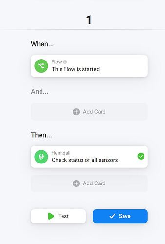

I am trying to do a special flow. I found a way to check all door sensors. If one or more of them is in alarm state i want to be notified with the name of the sensor or the zone.
Is it possible to perform that ?
ThanksâŚ
How is this related to Heimdall?
@DaneedeKruyff
Some guy told me to check out with Heimdall
Maybe put it in the right context would help
I answered your first question that you want to check if sensors are triggered and Heimdall is a fine way to do that, i use the functionality to check if all windows are closed when i leave the house. What you described afterwards is something else, no clue if you can also accomplish that with Heimdall, but you can do that using flows for sure.
But just tested it for you, and it is even possible with Heimdall, you just need 2 flows.
And ofcourse change the When card in flow 1 to the âbutton is pressedâ of your button
You will now get push notificatons (1 per device that is triggered, and it will put them on the notifications list in homey, but you can also send messages to Telegram, logs, signal, whatsapp etc, depending on what you want

Why not? Based on what you descibed you want a list of sensors that are triggered if you press a button, that is exactly what this flow does. If that is not what you are looking for maybe ry to explain what exactly you want to accomplish, pretty sure someone can come up with a solution.
@Chris_nl is right, this is the way to do this with Heimdall, if this doesnât fit your use case itâs off topic here and I ask you kindly to discuss this in the initial topic.
