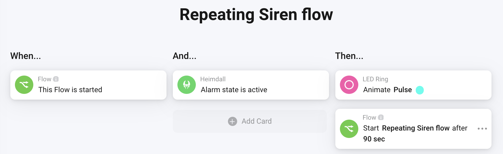

When not using a dedicated Siren device you can create flows like these to accomplish what you want:
Replace the Led Ring card with the Soundboard card to play your desired sound and adjust the delay on the Start Repeating Siren Flow after to the length of your sound. In the else part you could add a card to stop playing the sound (If that’s supported by the Soundboard app)

Thank you Daneede. Didn’t know yet you could trigger the flow again from within the same flow! Very handy!
