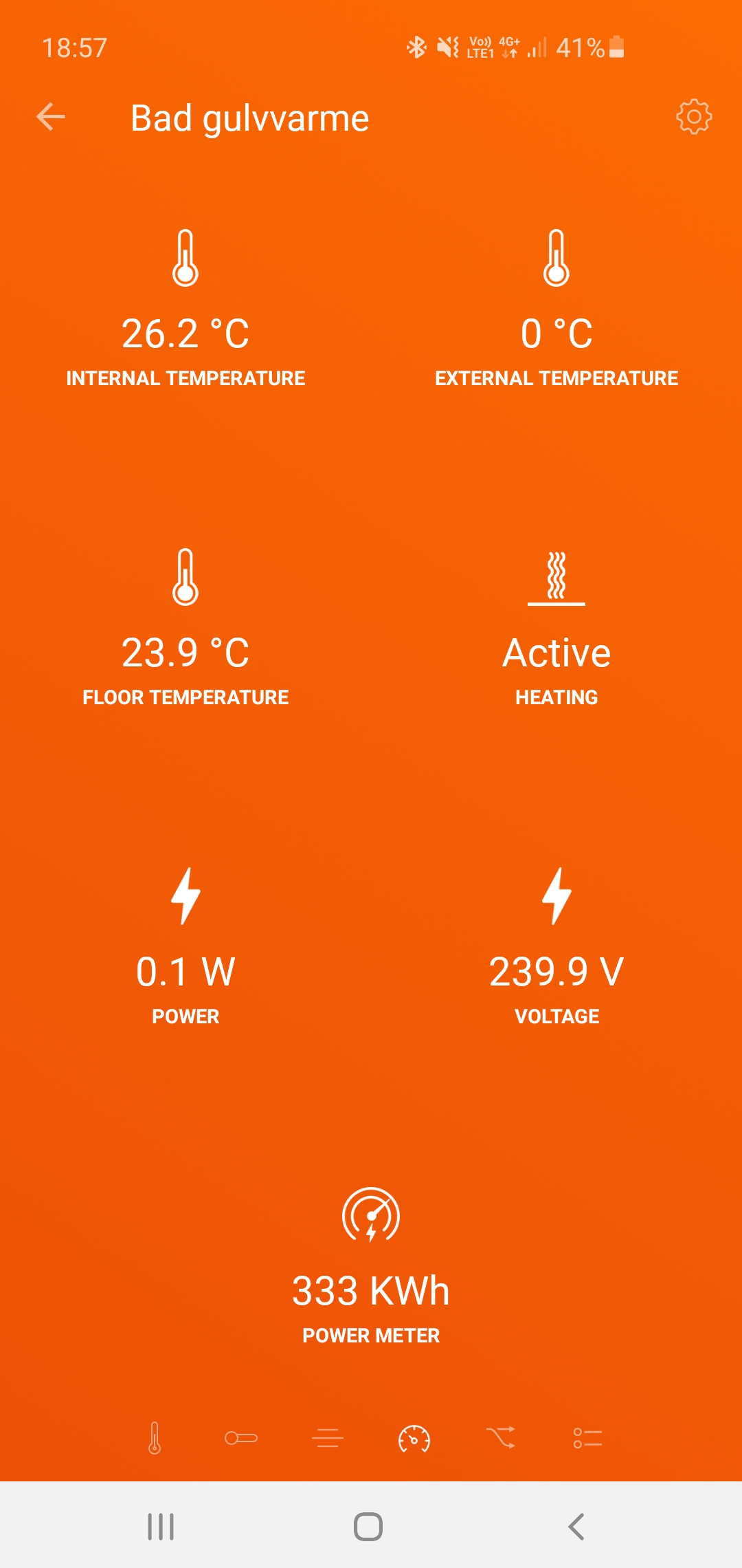

My z-trm3 stopped reporting power usage for about 2-3 weeks ago. I noticed it was reporting constant full power usage all the time, and it haven’t updated in about 2 weeks. Reboot of homey did not help. But when I changed language to English (to take screenshots) and rebooted it suddenly changed to reporting 0w, so I thought it started working again. But sadly not. Homey never receives any updates regarding to power usage. But temperature is reported as normal.
Should I exclude and include again, or can something else be wrong?
All my z-trm2fx works as normal.
See attached screenshots.

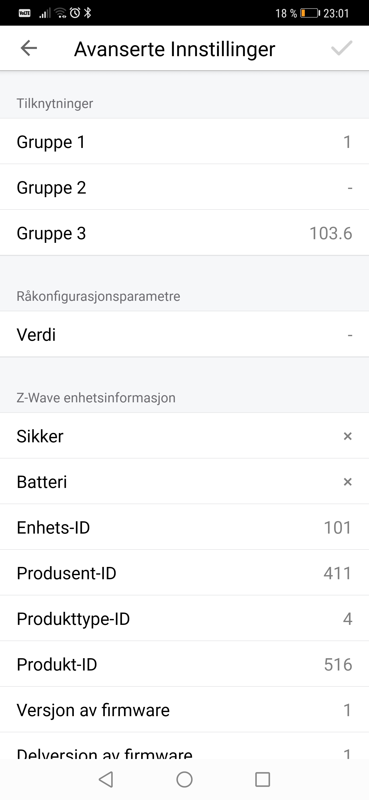

Ok, sorry. I just tested “the “1.1” association group override trick (set the value to 1 and then back to 1.1)”, as @Naitsirk wrote earlier, and that worked!
I did not fully understand what I just did, but it worked.
manged to fix it. Changed the settings in Group 1 from 1 to 1.1 in both devices… it seems to work now :slightly_smiling_face:
