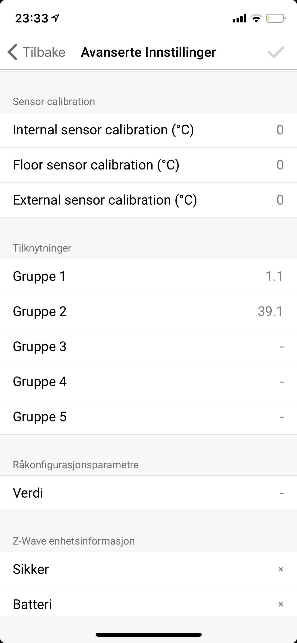

How do i associate my z trm 3 thermostat and z water relays. Is it in group 2? What value do i put there? Device is and relay nr and what more?

@Nerohan_Selvendran you will need to check what the Node ID is of the Z-Water. Suppose it is 23.
Then you will need to add to association group 2 of the Z-TRM3: 23.1, 23,2 for respectively the first and second group and then press save.
So it is adding nodeID.x (separated by comma’s) to group 2 of the Z-TRM3, where x is 1-10 for the 10 different relays of the Z-Water…

It does not work. I’ve done this.

you have the same ID for this device and the device you want to associate ( in gruppe2), here you need to insert the ID of other device, according the description of Ted.

The picture nr one is fron the zwater relays ans picture nr 2 is from the thermostat :slight_smile:
