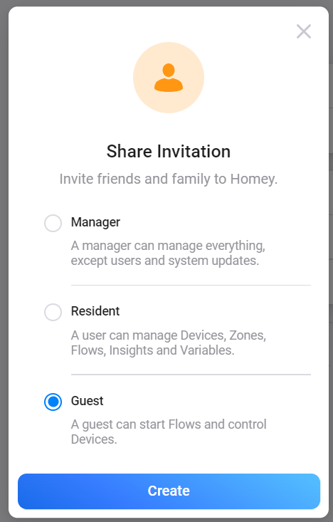

I invited a “Guest” as a Guest from the mobile app, and I am the Owner.
I checked the rights from the linked page prior to inviting the guest. For the flows, the guest role is “view and manage” and not “view and start”.

Sorry about the confusion, I meant : the role should give « view and start » rights and what I see for flows is « view and manage ».

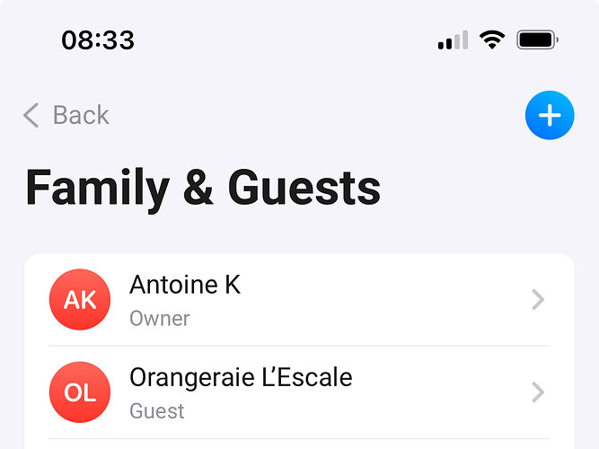

I created the user as shown on the screen copies. User accepted the invite and is listed as a guest as shown here :

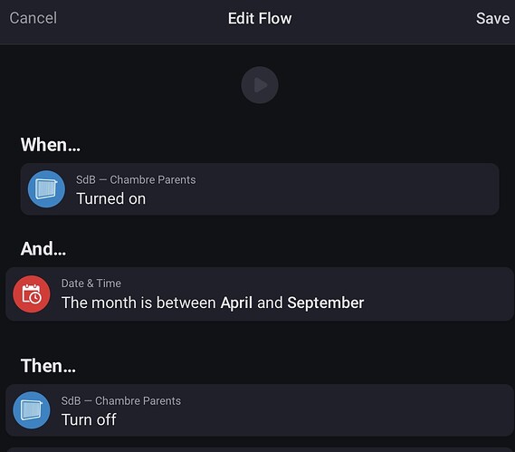

And yet this user can edit flows and save them :
User can do anything they want to the flows including « save » but saving does not actually save anything. The flows stay untouched.
Correct,
Guests can edit flows?
so Yes they Can edit but effectively not as they cant Save them…
