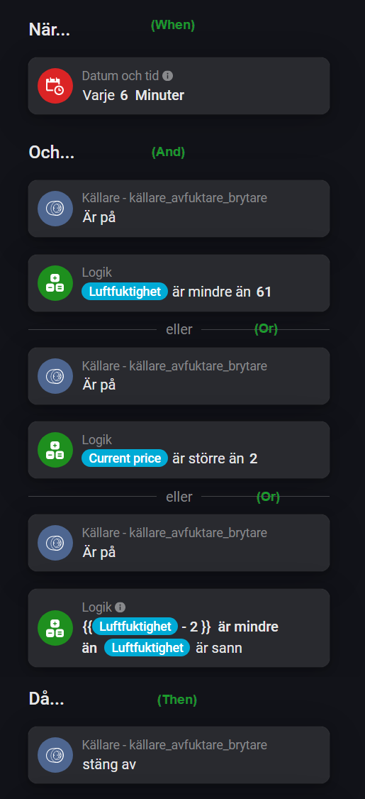

To clarify what Roco said: There is no equivalent for braces. But you can get what you want by repeating “ Dehumidifer is on” on both sides of the or:
And
dehumidifier is on
humidity < 60
or
dehumidifier is on
price of electricity > 1
@Edwin_D, thanks. That’s what I did. But I was hoping I could do away with the repetition.
Sadly, no.
This is what I have:
