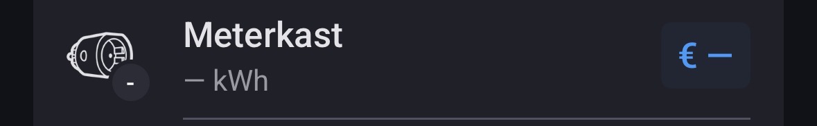

I have a question, i have 2 grillplats from Ikea in the device it registring the power usage
but the device in energy is stays at –
Do you also have this problem? or is it just me?
Or is this a bug in the app or in homey?
Thanks!
I see it has used 0 kWh. Have you just added it? It might take a while for data to show up
it’s been there several months already, and always been like this
The issue is that the smart plug doesn’t report its total energy consumption (you can see Energy is 0 kWh). Have you tried re-pairing it?
I repaired the connection with homey and that solved it!! thanks!
