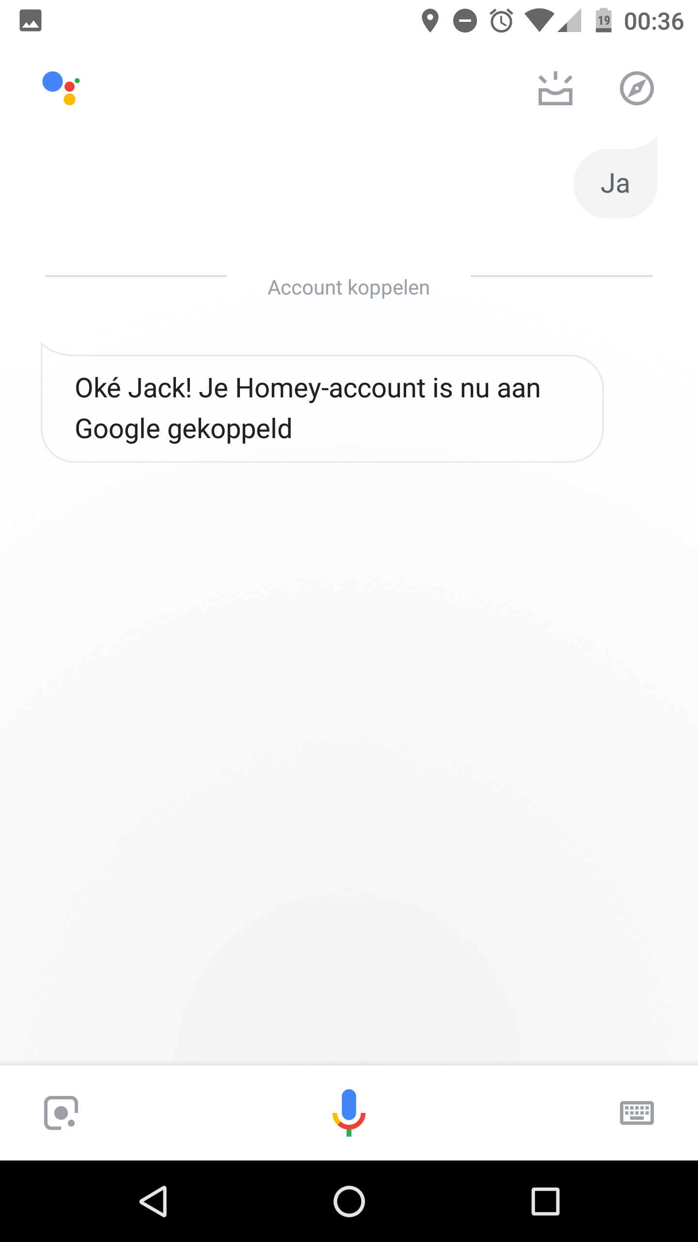

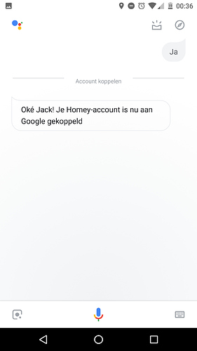

Athom Homey language is set on dutch.
Google home assistent (on android phone), language set on Dutch:
1- “ok google, praat met Homey [talk with Homey]”
2- response on phone:
3- click on “toestaan [allow]”
4- response on phone:
Seems like they are able to connect and with this they have removed the issue: “I didn’t find Homeys that can be used with Google Assistant. Please make sure your Homey’s language is set to English”.
