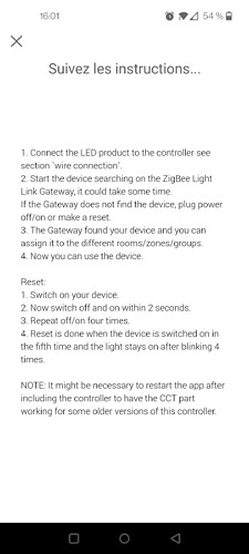

Thanks for yours answers but I’m stuck at the step on the screenshot…
And I don’t have an Hue bridge…

Just as said,
I added the direct to Homey using the App Gledopto and Tint lights and LED Controllers (ZigBee) App for Homey | Homey
Just your Homey and the Gledopto GL-C-008
The reset is just like the reset of other brands like the IKEA (see Video https://www.youtube.com/watch?v=mJm9YpPrGzk ) but then 5 x Off - On (IKEA is 6x)
Don’t Switch the transformer as the Capacitors keep the Power to long and/or start to slow.
Put a Switch between the transformer and the controller. (or toggle the 12 Volt connector or wire.)
If I Remember correct after the Reset I started pairing in Homey and power-cycled the GL-C-008 once again.

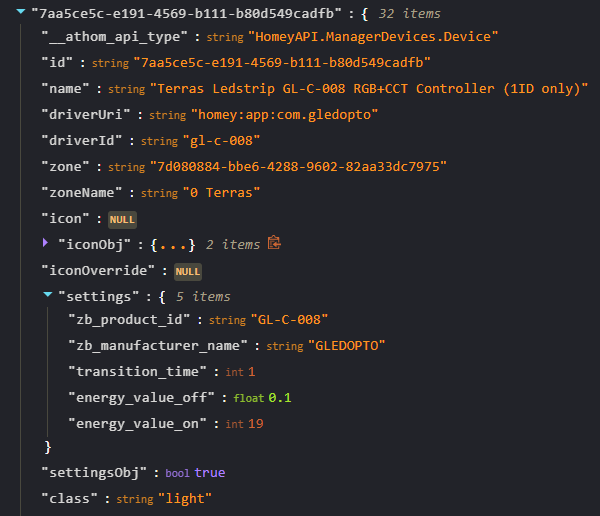

Edit: Correct @janklamer below. I looked up my Gledopto in the WebPlayground but to check device vs driver etc. but it is of no nues for a normal user. hidden by now!
Works perfect
now I am puzzled, what does the piece of code mean?
there is coding “behind the scenes” but the normal user does not have to dig in that far :crazy_face:

@limplug I have quite some experience with this. I can understand the confusion if you’re not familiar with some processes yet. Everything is said in above posts, but I’ll try to simplify it step by step how I add these.
  • in your homey app, go to add device
  • select gledopto app
  • select the correct type (keep in mind that the 2ID version of any of the mentioned devices is not supported! Ping me if this is not clear to you)
  • you will see the description page you mention you are stuck in
  • plug in/turn on your led controller (preferably with led strip attached for visual confirmation)
  • tricky part that is probably failing for you: if the controller won’t be added automatically in this screen after a couple of seconds (let’s say 5 seconds), you will have to reset it (as it’s already connected to another device). Resetting is done by turning the controller off and on 5 times. As mentioned in above post, it’s best to do this by using the power cable from the controller and not by cycling the power of the transformer as that will have capacitors making the process impossible. When this is done correctly and you have a led strip attached, you will see that the led strip will fade and start blinking. The device should be added by homey in a moment now (this can take a couple of seconds again)
  • enjoy your led strip
Couple of notes:
  • adding a device can take quite some time. Do not cut off the power during that time and just wait (this is a general remark, not specific for this brand)
  • for me, the color markings on the controller for the led strip were not correct (rgbw). I always had to switch 2 specific colors when connecting the controller to the strip, but I can’t remember which one (test this when the device is added to homey before installing it and correct if necessary). This is not specific for homey as I also had it with my tradfri hub.
  • @janklamer I add my zigbee devices to homey where I need them, not near homey. I never encountered issues doing so (which seems logical since zigbee works as a mesh network). I do always restart homey after adding router devices to make sure the network is correctly set up. Not sure if this is actually needed though.
    @janklamer the reason there is a mention of the hub in the pairing screen, is because at the time the app was created, this was the generic text from gledopto itself on their product pages on how to include the devices
