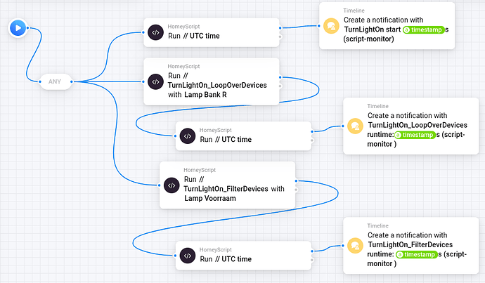

I like performace tests:
Bulid a view setup flows:
const device_name = (typeof args[0] === 'string')
? args[0]
: 'dummy';
let device_id
const devices = await Homey.devices.getDevices({ filter: {name: device_name} });
_.forEach(devices, device => {
log(device.name + ':', device.id)
device_id = device.id
return device_id
Be carefull, you should start the flow from your mobile to get a real life stop time.
Play with the filter, in my test I found out that the filter is 8-10 times faster in compression to collect all devices and loop through. Depends on the amount of devices of course.
It takes 0.09 sec to identify the id by name of the device.
Wow, that makes a huge difference, it’s around 1sec faster than looping over all devices. (I have 281 devices).
Thanks for digging into this.

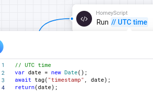

Screenshot from 2022-07-09 15-31-25
Oh, and, you can start a flow like this too:
