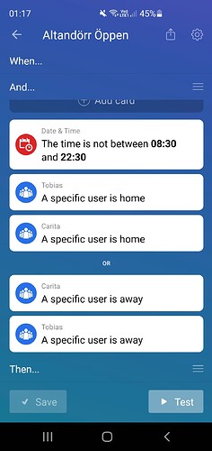

I have set this up in the and…
I have a static ip for me and my partner in my router and added us as “device” in the SP app in Homey.
Tested by disable me and my wifes wifi but I don’t get any push.
Edit: Does it have anything to do with the defult delay setting in the SP app wich is set to 900 sec/15 min?
Does this mean that I have to disconnect from wifi at least that time and then if I open the door I will get a push?
I can update you with that the flow above works. I missed that I had to wait 900 sec for the flow to trigger.

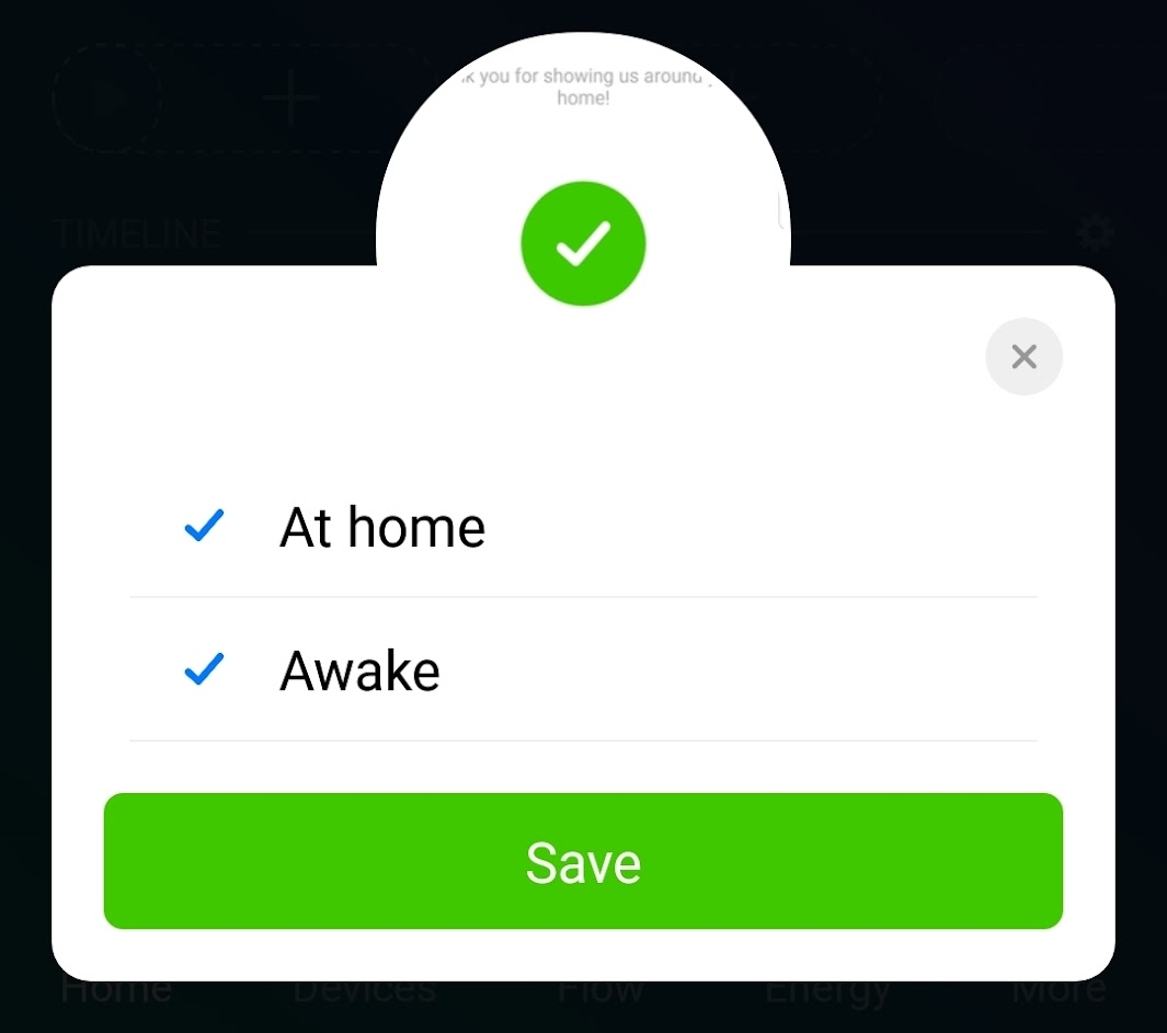

Did you checked if you and you wife were at home or were away if you tested the flow? That’s really easy!
Home
IMG_0622
Not at Home
IMG_0623
That’s the reason why I said you have to figure out how the SP app works.
Btw, why are you using “A specific user…” condition cards instead of “Household members home/not home”?
And why you don’t want to use GPS?
About household member, I didn’t think of that but I will try that instead :+1:t3:
About GPS I think mostly about battery drainage, avoiding that. Don’t use the GPS often so I think thats why.
