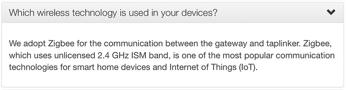

What network does linktap use? Is it Zigbee, zwave or 433mhz.
Source
Thanks. And I believe that Zigbee uses the same frequency worldwide, so it will work fine in Australia. Is that correct?

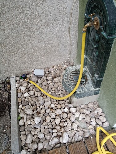

I used thed valve you can see on the picture (sorry I don’t manage to find my order and the reference !.. I suppose I bought it directly from Wish or Aliexpress, I cannot remember :frowning:
Concerning the ON/OFF module, I bought a simple inexpensive ZBMINI Zigbee that I put inside a dedicated isolated box.
I wanted to dismantle all my installation each winter, so I made it simple ! (but all works great !!)

Linktap is an Australian company so hopefully it works there :wink:
