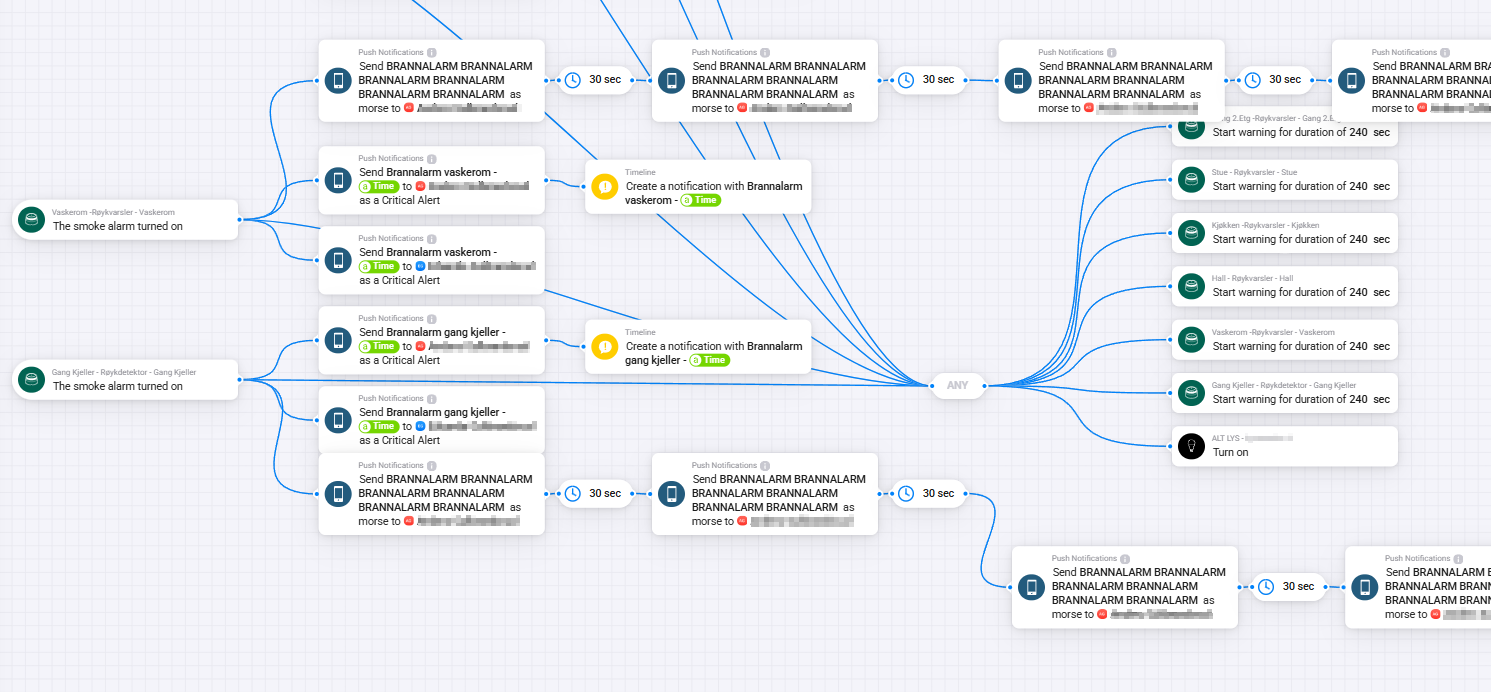

This is the flow to start the alarm. probably not the best setup but it works ok.
The homey critical alert barely works on my samsung phone, but i think the morse code works fine to create noise. Vibrates like crazy and impossibel not to notice unless youre several rooms away

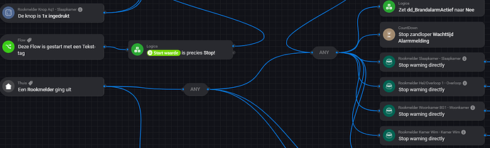

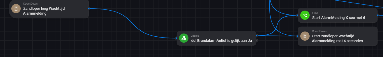

I start a different flow when there’s an alarm :
That flow starts an alarm on some smokedetectors for x seconds the repeats itself
When the originating smokedetecor stops, or when I press a button, or start a stop-flow, these stop:
When no smokedetector is triggered, all is silent, if there is a smokealarm triggerd, only that one will stoll go ff. And you can then locate it.
