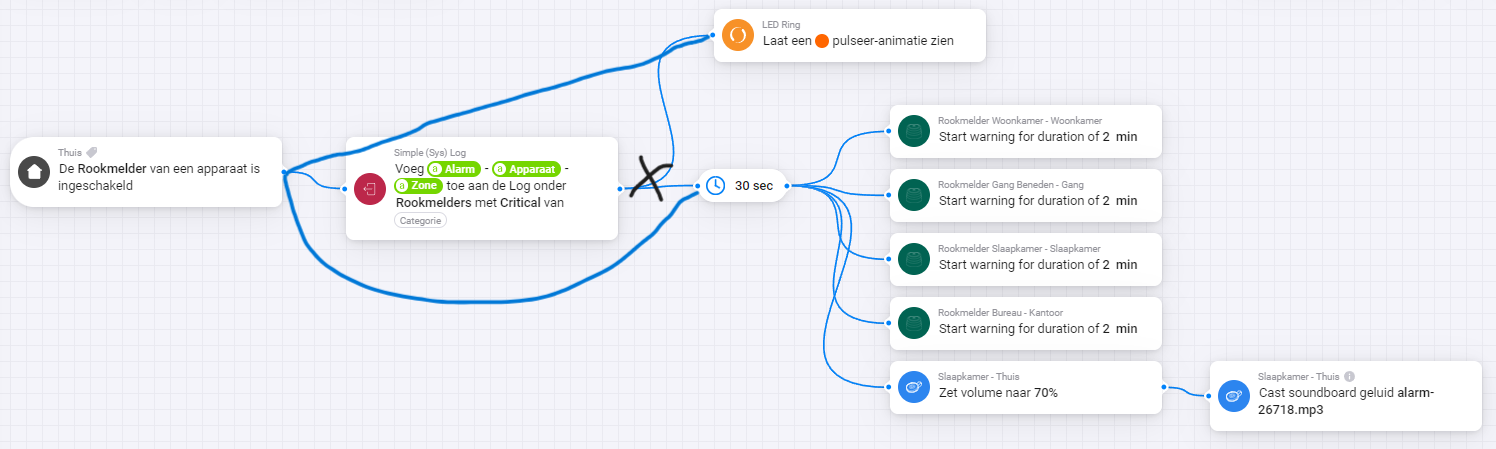

I made this advanced flow.
Does anyone have some suggestions to make it better?

Nice work! I have only 2 tips for you:
  • Your card to set media volume is linked from a smoke detector. This causes unnecessary dependence, eg. what if that smoke detector battery is empty? So better create a link to the media volume from the 30s delay connector
  • It is better to separate message notifications from your flows. In the below example I used Simple Log to log the message together with the flow name (“group”) and the urgency (“severity”). Once logged, it can sent a notification based on criteria.
    • saves a lot of cards in your current flow
    • easier to maintain
    • can be reused with your other flows
    • the log can be analyzed, filtered, exported separately
Also keep in mind that notifications are best sent out sequentially or you may cause skipping/overload (in some apps)
@Rrrr I followed your advice.
It’s a lot cleaner and now there’s 1 flow that can handling all the notifications :slight_smile:

@DirkG This is also a solution?
Pls connect the SimpleLog card in parallels, instead of series.
In case the SimpleLog app malfunctions, the flow doesn’t complete the way it is now.
@Peter_Kawa You mean this?
Yes, but as Peter already mentioned, I would do it like the lower screen shot.
@DirkG Result

Perfect.
Another hint: I’ve learned you (always) need to put a ‘stop casting’ card in front of the ‘cast something’ card.
Because when some cast is already going on at the same device, ‘Slaapkamer - Thuis’ here, it won’t start an other cast.
Progress here! Very nice.
One comment: you’re selecting twice the app group “Rookmelders” and Critical condition. There’s no need.
@Peter_Kawa @Rrrr
Thanks for the stop casting, I implemented also in the doorbell flow :slight_smile:
You have tested the flow in a ‘real’ test (meaning let the smoke detectors detect smoke)?

I test it the first time with smoke but when creating not anymore. Only the flows are tested.
I will do it asap.
Reason I asked is only in ‘real’ test you can find out if every stepp you took is usefull. For instance: fun using the led of the Homey when testing but probably no one will see it when a loud alarm goes off in the house. But as being also a very new user; it is fun to add some things in a flow just beacause it can :grinning:
Also: will the cards Stop warning directly do anything in a real situation? You only shut off the alarms you started with Homey and the last 2 minutes (??)
I did a test today and everything works fine.
Did some changements to duration and deleted the LED option.
:+1: hope you never need the flow.
