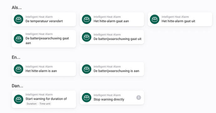

So i have managed to create an advanced flow to start all my alarms if the original alarm was not reset. But in the case we dont manage to reset in time (60sec) i would to to disable all the alarms by disabling 1 of them. But this does not seem to work.
This is my alarm deactivated flow which does not work
I am probably missing something or doing something wrong. Any input would be of great help!
To be clear when i turn of the alarms i puch the button on the frtient alarm to deactgivate ther alarm. I would think that the “When The smoke alarm turned off” would work for this but it does not.

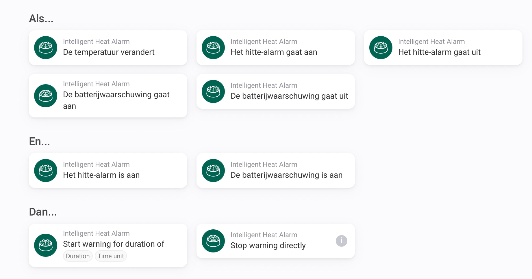

I don’t have a Frient smoke- or heatalarm, but based on the available cards:
First I would check whether the flow is triggered: add a ‘notification to timeline’-card after each trigger
When the flow is triggerd: I’m guessing you let the other alarms sound by using ‘start warning for duration of xx minutes’-card. Maybe this card will keep running despite the ‘start warning for duration of 1 seconds’-card.
To test this you can disable all the ‘start warning for xx minutes’-cards temporarily.
If this is true: If I understand the text under the information button correctly the ‘stop warning directly’- card can only stop the warnings started by ‘the start warning’. This may means you can stop the other alarms but you have to reset the alarm that started it all?
That will not work, your trigger is ‘when alarm goes off’, but you can’t switch off the alarm on another Frient, it has to be on the one that notified you of smoke. And that one you cannot disarm remotely.
I have a similar flow, but als buttons around the house to silence all alarms that I switched on by the flow. Then only the originating alarm will stay on…
