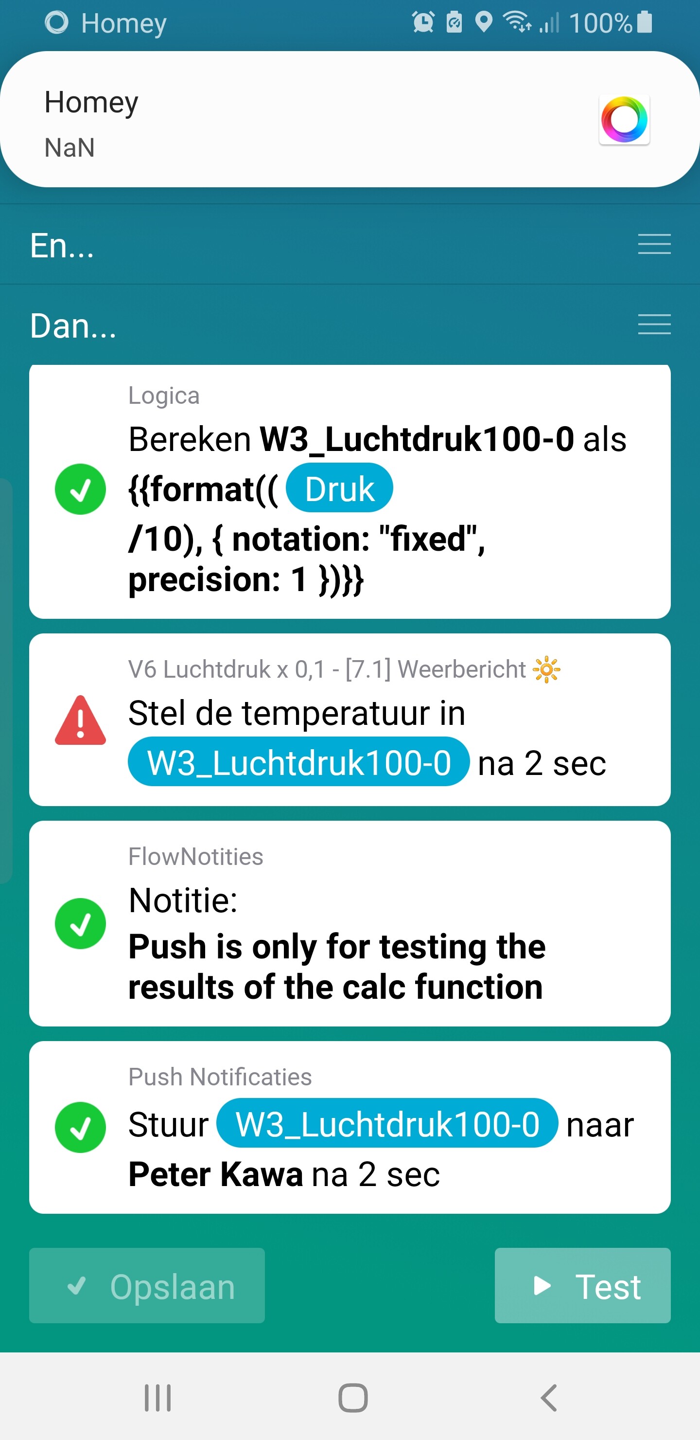

So, with this Logics card ‘calc a value’, I want to accomplish 100 to be shown as 100.0 like this, but I get NaN values returned.
  • I tried this:
{{format(100, { notation: 'fixed', precision: 1 })}}
{{format(100, { 'fixed', precision: 1 })}}
{{format(100, { fixed, precision: 1 })}}
{{format(100, { precision: 1 })}}
{{format(100, { 1 })}}
Something else:
This should round to 1000, but it also returns NaN:
{{format(1234, 2)}}
Background of what I’d like to accomplish:
  • Vars used:
    • <W3_Luchtdruk/10> - a Logics NumericVar
    • <Druk> - a value between 0 and 2000 form a airpressure sensor
      VirtualDevice type Thermostat - should display 100.5 or 100.0 as airpressure
Calculate <W3_Luchtdruk/10>
as
{{format(<Druk>/10, { notation: 'fixed', precision: 1 })}}
Flow:

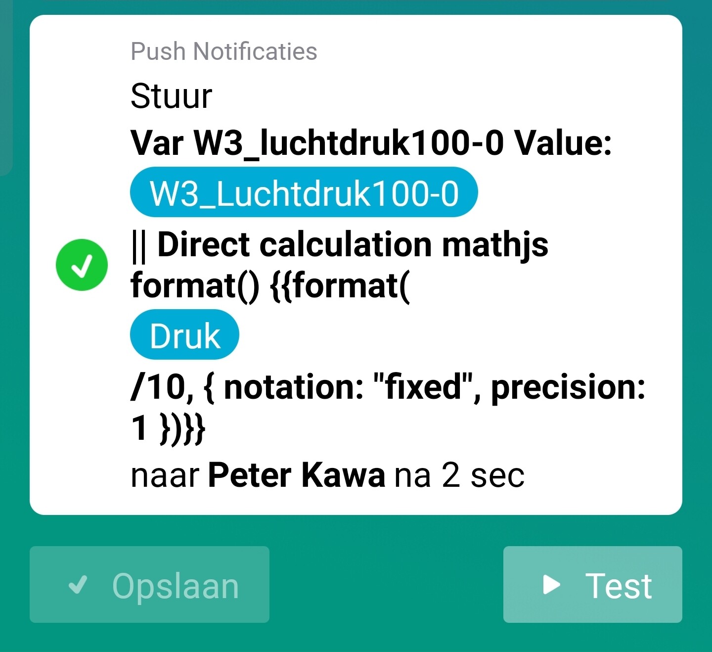

Not sure what you’re doing wrong, that works just fine for me:
and the result:
What also works is this:
{{ format(1234, { precision : 1, notation: "fixed" }) }}
If you use single quotes (or back quotes) it stops working. I guess Athom still hasn’t worked out the parsing issues in flow cards.

This worked for me as well, Robert, using the math directly in the push message
I found out it doesn’t work with the native logic “calculate a value” card, the result is an empty num var:
But, it works a little bit with better logic “Execute matjs expression” card, but the result stays zero
Again, in the push message it works fine.
Now I have to find out how to get the calculated value into the virtual thermometer…

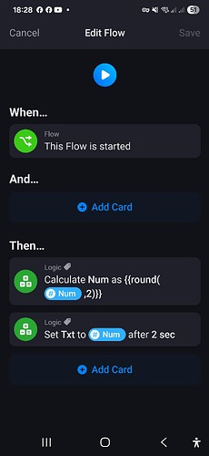

I think you will need to use the calculate card to round the number and then convert that to text.
Thanks, this seems to work fine:
When I run this, card #2 does the rounding and card #4 produces the correct 2-decimal numbers in the Timeline. Since Num already has 2-decimals (due to the round function), I don’t really need the Str variable (card #3).
