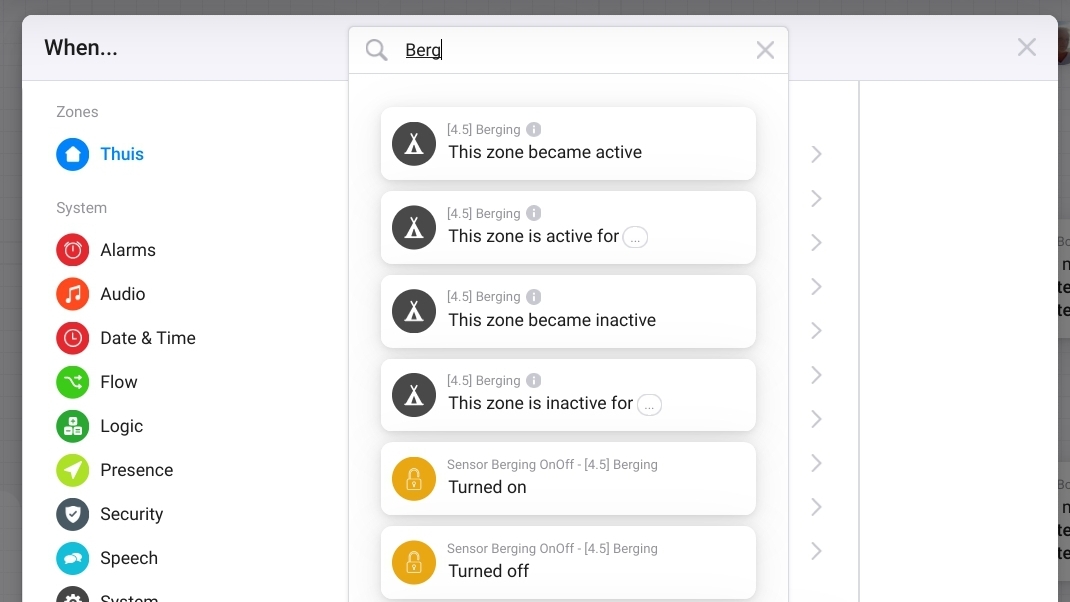

Of course Homey recognizes it as a OnOff switch, or doesn’t it? Does Homey think it’s a thermostat, or speaker?
