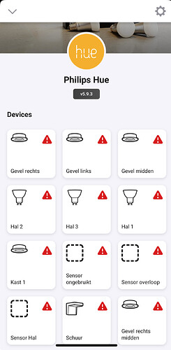

Notice all devices in the Hue app being unavailable….
So that’s the reason your flows are broken. I can’t help with fixing the Hue problem though.

How can I do this? When I look in the Homey app at “My apps” and open the Hue app, I don’t see a restart option.
Tap on the gear in the top right corner and the restart button is at the bottom.
I believe it did fix it. Cannot check in real as i’m not at home atm :slight_smile:
