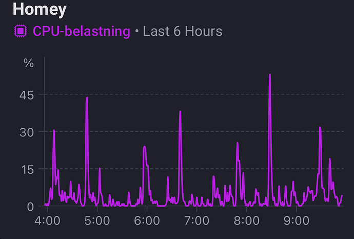

Insights shows a strange peak in CPU load every second hours or so, there is no flow that runs in that pattern. I then guess that this is related to the Homey pro HW/FW.

Olex, is this issue still happening ? If so, can you please share the screenshots, when this issue happens ? And also overview of your apps from Setting - General. Simply re-share the documentation/evidence, you shared for sure also with Athom support.
