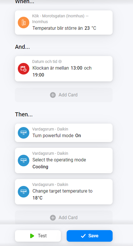

Anyone know why?
I want my Daikin to power on and set to cooling when the degress on my Netamo is more than 23.
The flow will be only triggered when the temperature goes up from < 23 °C to > 23 °C and the time is between 13 and 19 o’clock.
It could be, that the temperature change happens only once a day.
If the temperature rise over 23 °C at 12:59 o’clock, the flow will not be triggered.
That worked great! Thx!
