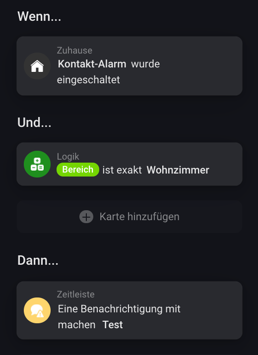

If I understand you’re requirements correct, than you’re on the right way!
When…
– A contact alarm is turned on
And…
– Logic card “is exact” or “contains” → tag “Area” + type in the name of the room, e.g. “Room A”
Then…
– Whatever

Thanks both, I’ve gone with the simplest option using the Logic card
