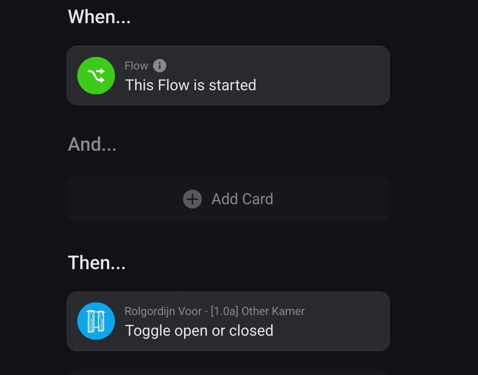

The only way (I know of) is to create a second flow which controls the door, add it to favorite flows and add it as widget to your phone screen.
Use this trigger card:
