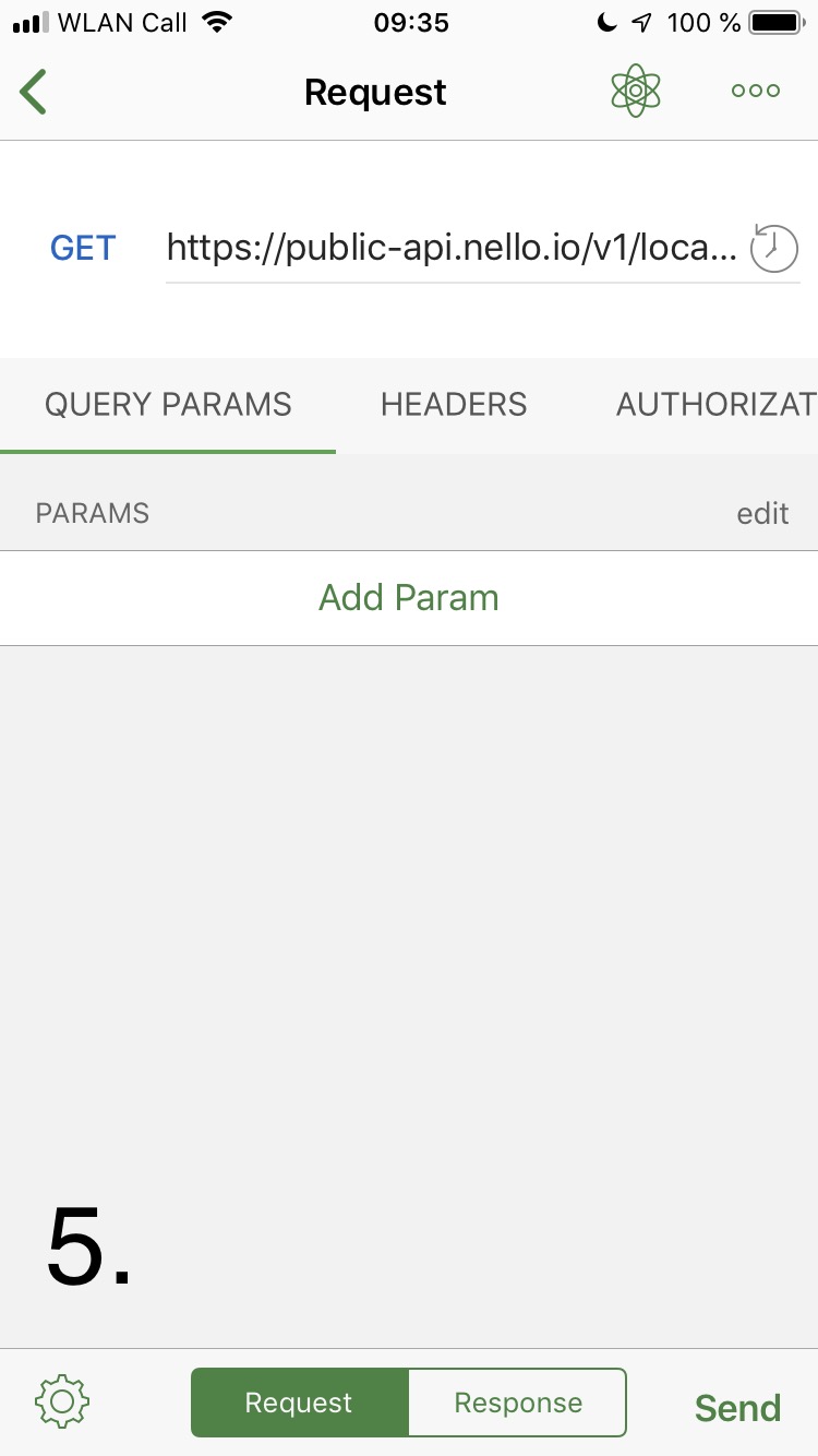

before after pic 3 press send

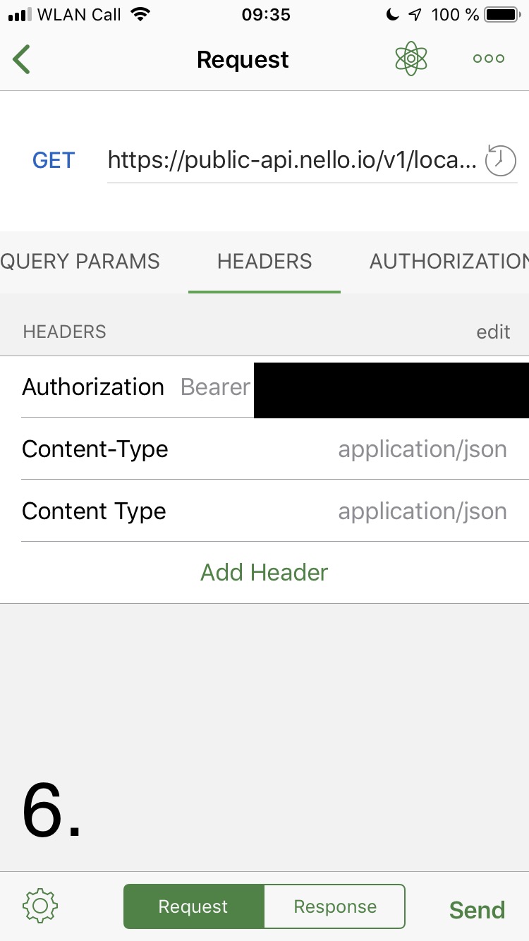

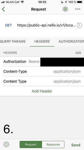

press send after pic 6 to get respone (pic 7) the location_id

when you enter your wehook url from homey and press send you get the final answer pic 11.
this steps only change api to webhook data for the created user. you can add more when you create a second new user and …

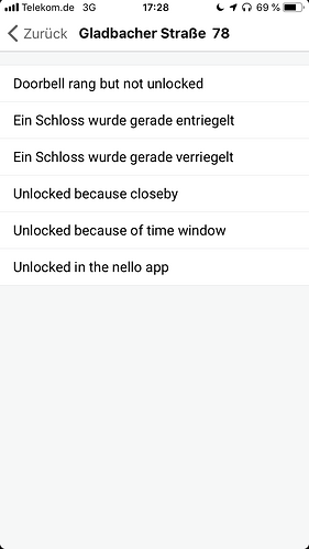

With the new version of the nello app 1.1.0 you can create a flow with doorbell .
