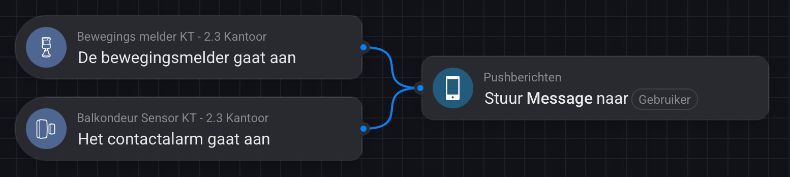

Can you share your flow?
By the way: there is a dedicated flow card for sending push notifications. Either to a specific user or all users. No need for a script :grinning:.
For instance, this example ‘merges’ two triggers (door sensor alarm and motion sensor alarm) and sends a push notification when either of them occurs.
