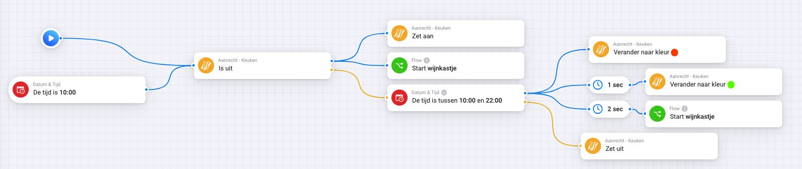

My solution without timer or loops:

Correct. The light in the flow from Bdl was called:
“Wijnkastje” is the name of de lamp

I still don’t understand, what does “start flow wijnkastje” do?
When this flow (wijnkastje) is started for the first time it will turn on the light and restarts itself.
After the first time the light will be on, so between 10:00 and 22:00 it will turn the light red, wait for 1 second then turn green, wait another second to restart itself.
the result is: The lamp is one second red and one second green.
This normal flow loops too, by calling itself, but you can not stop it.:grin: only by changing or disabling the flow.

It turns out afterwards that Bdl made his flow as an exercise to get the hang of loops.
