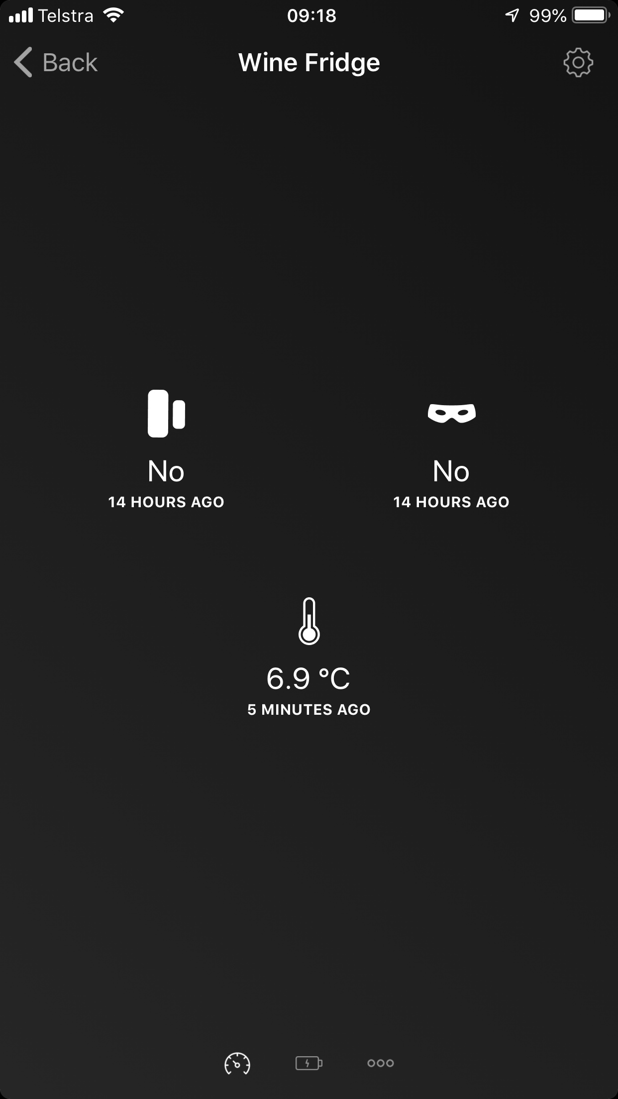

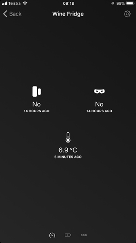

And gave it a new life (or dead sentence :stuck_out_tongue_winking_eye:) I put it inside the wine fridge.
It gives me the temperature and if the door is open.
Perhaps it likes the cold since there has been reliable.
