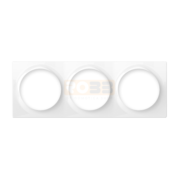

Remember, the Walli’s are very new and not all accessories are available yet!
FI, these are not yet available.
At least, mine are still in backorder.
Also, the Walli Controller, a battery powered switch, is also not yet available but should be somewhere in september.
