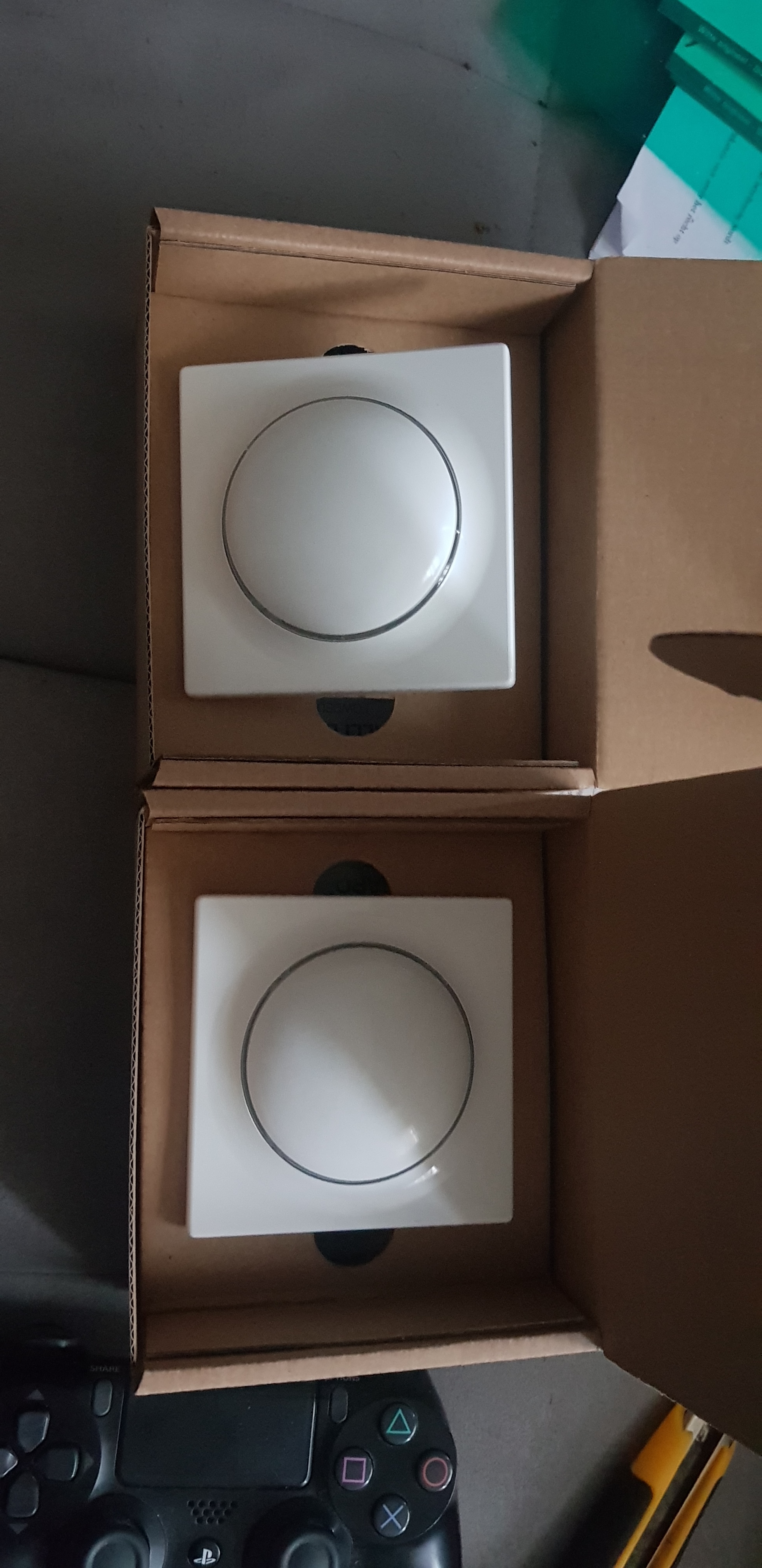

Here is walli dimmer

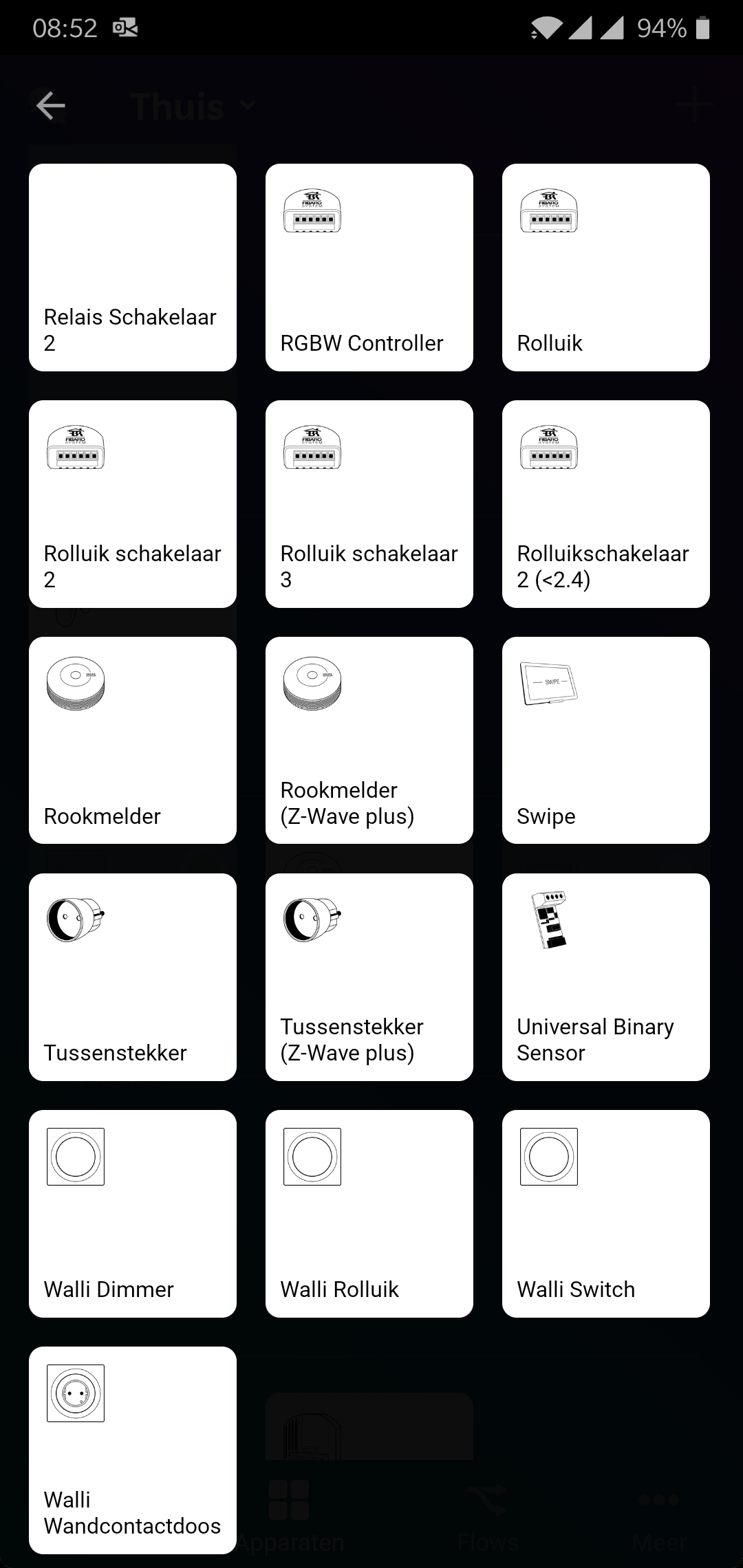

The new beta does support walli. Also walli roller shutter in Venetian blind mode. You get 2 devices then 1 roller shutter and 1 roller shutter angle. However it is called ‘roller shutter’ in adding devices while the dimmer is called ‘walli dimmer’. Bit confusing.
Screenshot_20190810-235535_Homey
