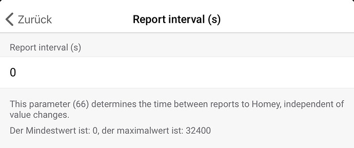

In regards with the internal temperature, that’s… internal. It is heavily affected by the internal electronics temperature, for example when you switch ON one output will start raise, switch ON both outputs and will raise even further. Hence, I’ve turned it off so it does not flood my z-wave network with unnecessary stuff.
Because I didn’t found on option in the advanced settings of the SI to turn it off, I looked into the manual and found this:
So the minimum interval (according to the manual) is 60 s.
5 s, as you set @Franky29, should not work correctly.
So the description of parameter 66 in Homey is incorrect:
(Translation of the German text: The minimum value is: 0, the maximum value is: 32400)
Also the description of parameter 65 ist faulty:
(Translation of the German text: The minimum value is: 0, the maximum value is: 16. The step value is: 0.1.)
Could someone of you please check if the description of parameters 65 and 66 are also incorrect in English?
It’s the same in English.
Thx, so I will contact Athom.

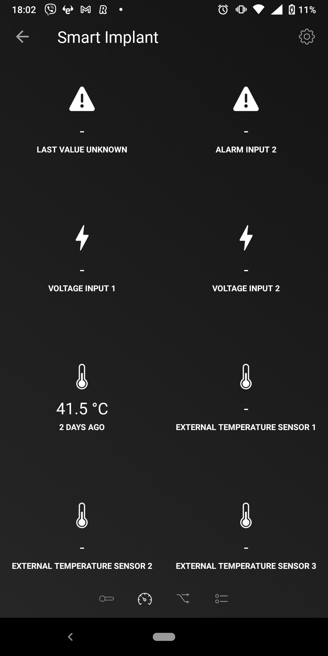

Hi, I’m having the same issue as Franky29.
I added a Fibaro Smart Implant to Homey, but the implant does not report any values. Only Internal Temperature is set once. And it is not updated anytime.
I was trying to change settings according to suggestions here. Like changing Group 1 from 1.1 to 1 and back, different settings for report intervals and thresholds. I was even trying another SI, but nothing helped me.
SI is working fine. Outputs react on inputs correctly and even setting outputs from Homey phone application works.
Si is just not sending any values or events. So none of my Flow is triggered.
Any advice ?
