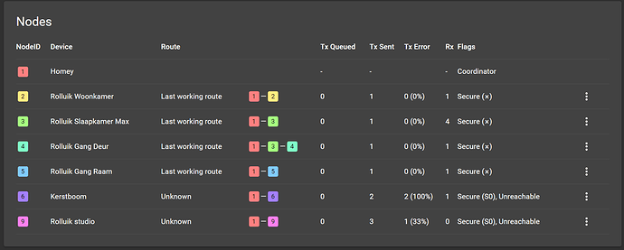

Could you please post a screenshot of the RS3 in Developer → Tools → Z-Wave.

Hi,
See screenshot below for the info.

You definitely have problems with the NodeIDs 6 & 9. They don’t have contact to Homey. This can be seen from the fact that the route is Unknown.
