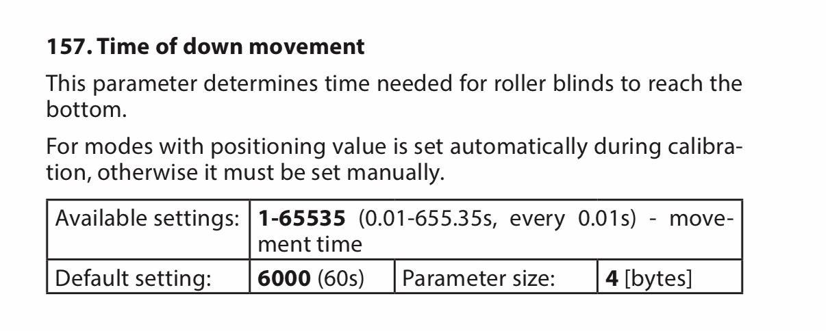

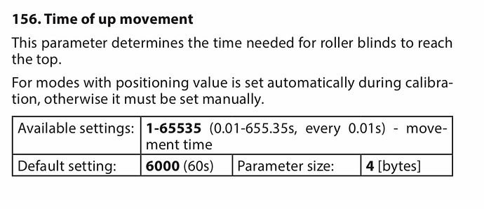

When operating via a relay you have to set the parameters
time of up movement and
Time of down movement

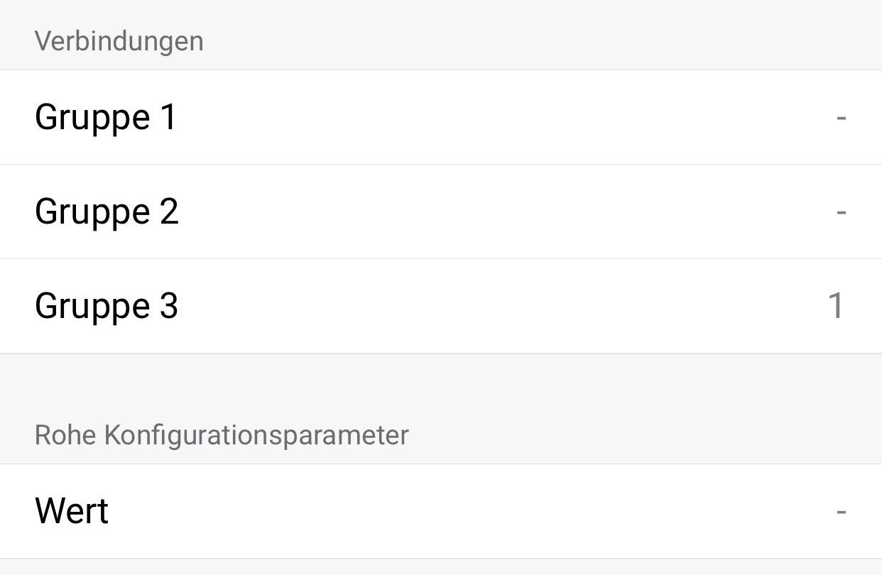

Here?
image|230x500

Device Settings
Parameters

but is 156 the id?
is the size the time?
then what is the value?
Say my screens take 20 seconds to roll down or up, then how do I exactly fill in those values?
156,4,2000
157,4,2000
After edit the parameters you must save the changes!
