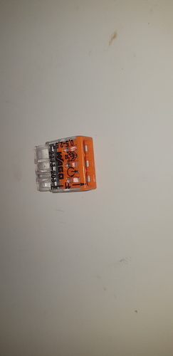

vd-draad-lasklem-3-draads-verpakt-per-50
Learned
Given the url from the image, this is obviously from a Chinese site. And i think we all know how much they value certifications and regulations… :thinking:
Actually those are good connections (though that isn’t a ferrule), wago makes them, but Goodluck getting that behind the switch also, as the module itself uses 90% the wires 8% and the 2% is air that the wires need to get pushed in.
Solid wire fits fine in a 50mm box
Btw these Chinese version of wago is rated 10A, the wago is 25Amp
Sure, the solid wires, but not 3 pieces of the 3 latching terminals, AND the dimmer 2 module, AND the solid wires.
Plus the last one that are shown are only allowed for solid core wiring, not the flexible wiring, even with ferrules.
Not sure why you would need 3 of those. 2 wires from switch to fibaro and 2 from fibaro to lamp. No need for these latching ones in this case. And with 3 wire you still don’t need them unless you have 2 outlets and a switch or 2 switches. But still it would fit then with a bit of fiddling, not saying it is easy though. And yes solid core obviously. PS: its not a contest you know…
