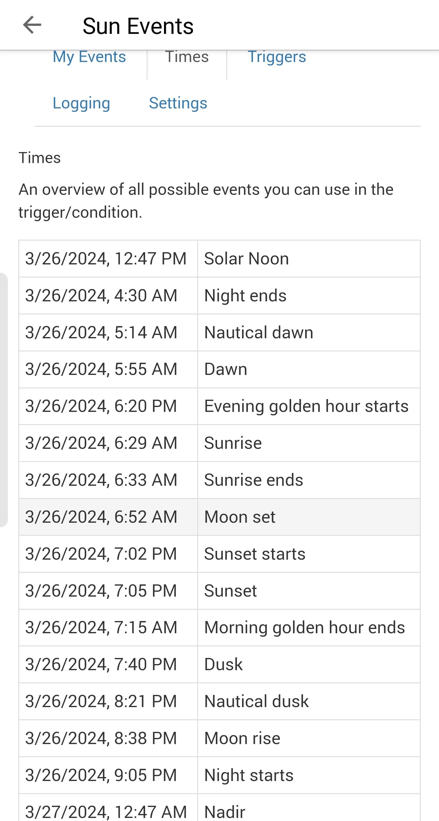

Are you talking about the Sun Events app, or the build in functions?
I’m using Sun Events app because the built in is even more limited (offset only up to 60 minutes before the event).
That is not necessary, Brane, while the app provides for many events during the day/night → you can select an other event which triggers earlier or later than the sunset/sunrise events, and on that event you can use max 60 minutes offset again.
