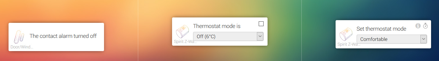

today i link the above thermostat with my homey. now i can change the temperature over the slider within the devices section.
up next i create 2 flows.
so actually no flow works and i don’t know why. (if i test the flows manually the first flow works, the 2nd not.)
the window-sensor send the contact alarm and i can change the heating modes manually, but if i want to use a flow it doesn’t work?
thanks for help

I have the same valve and it works fine with me. When i open the window it closes en when i close the window it opens. Flow is in Dutch but almost the same only i do not use the "and"colum.

it might be that the condition cards don’t work properly (will be working again after rewrite to SDKv2), you might need to change them to “logic” cards and check the tags (at the top) value of the state for now.
@Caseda
Not sure what you mean. Condition card is the IF / trigger?
Condition is the AND column, so the thermostat mode is/isn't
Thanks!
okay thanks! i changed like you said but it doesn’t work?!
