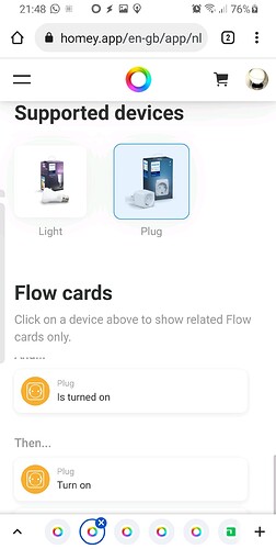

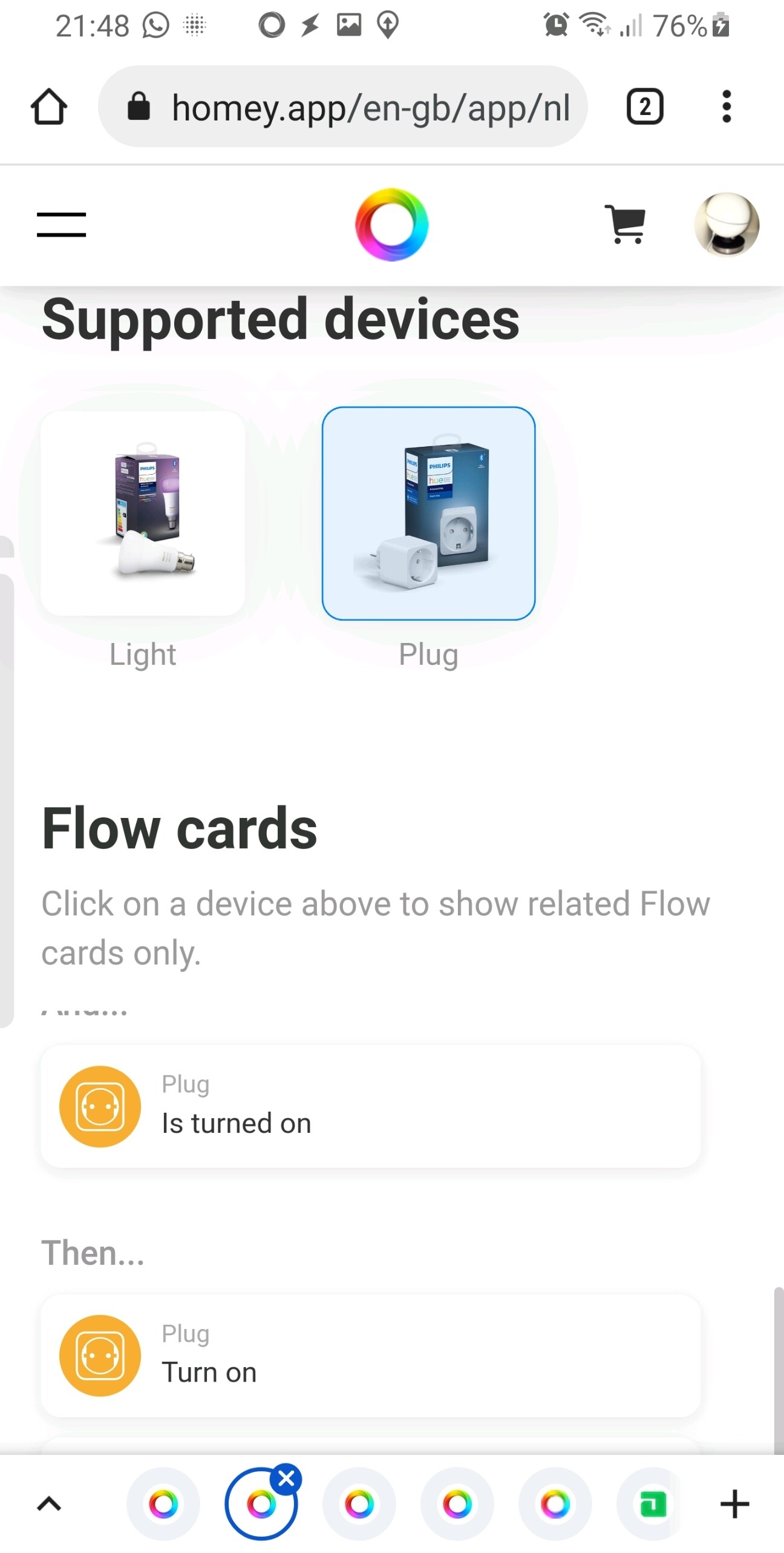

If your plug can be paired with the Hue bridge, it should, in theory, be controllable by Homey cloud.
BUT, not now. It seems only Philips hue plugs are supported atm.:

I agree what you have said: ā€œIf the plug can be paired with the Hue bridge, it should in theory be controllable by Homey.ā€
This is what I was thinking as well. When adding this new plug to the Hue bridge I was not expecting that I would not be able to add it as a device to Homey via the Homey Hue app.
It looks like that only Philips Hue branded devices can be added via het Homey Hue app.
