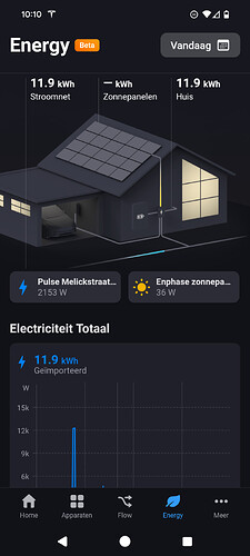

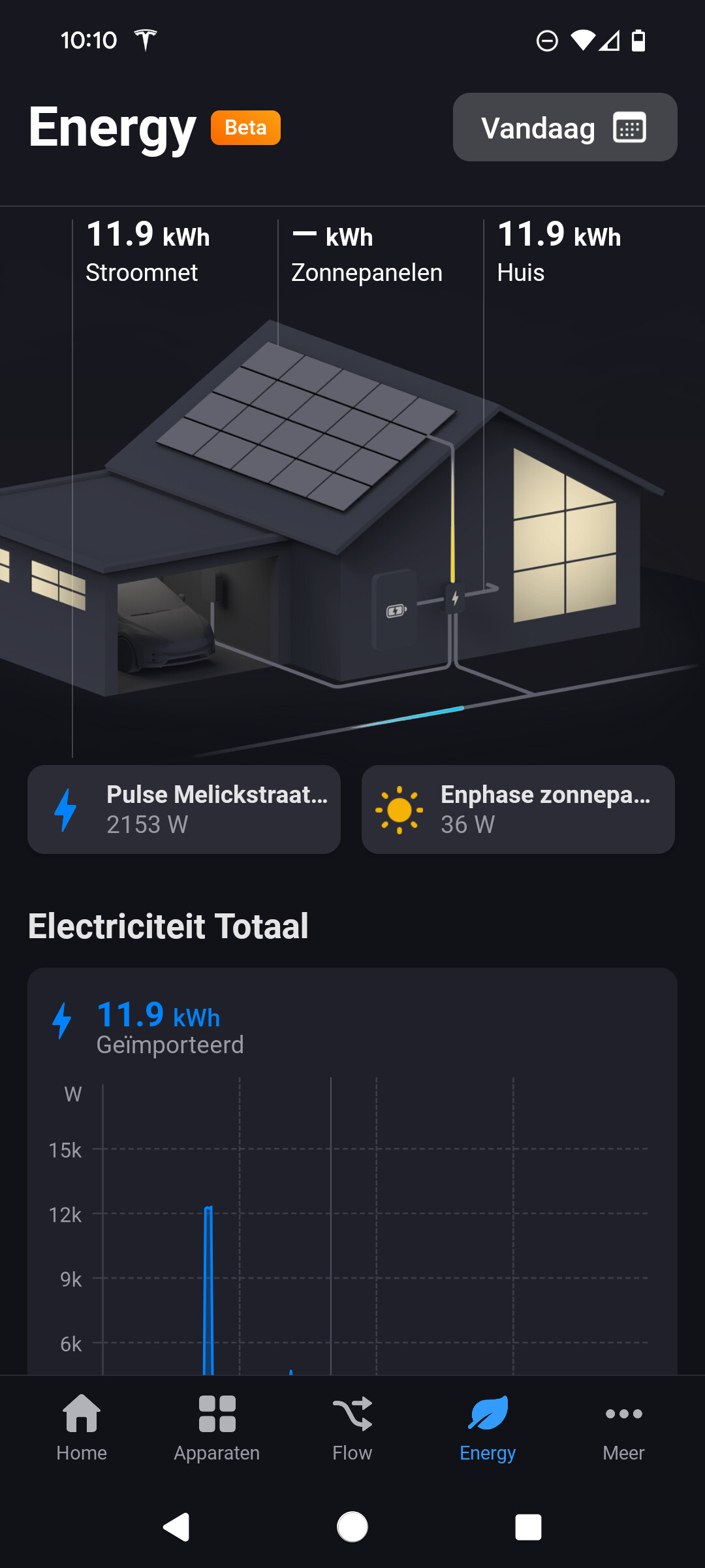

I had to pick another card to passthrough energy and power, and with that implemented I now see the power that my solar panels are delivering.
The energy is passed through now too, but as I did the change of cards just a few minutes ago it did not change vales so not visible yet.
Let us know how your solution works!
And also the energy counter is working as can be seen on the print screen below.
