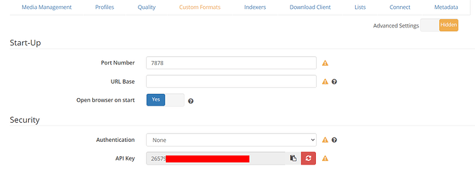

A quick question though, next to the API key in the Radarr UI, there is a orange triangle, statis that changes will be implemented upon restart. I can’t get rid of that even-though I restart. So I guess this triangle will always be there regardless if I had made any changes, correct?
The triangles are there indicating an advanced setting. Not that it’s not been saved. The API key here however is not the correct one. Follow the instructions in the first post of this topic to get it working.

You say that the API key that I use is not the correct one and referring to your initial post, but the only instruction is regarding the API is:
First add your Sonarr and/or Radarr installations as devices in Homey. You will need to fill in the IP address and API key.
The only API key related to Radarr is the one I find in the webUI, what API key should I use?
You are right, my bad. That is the correct key.
