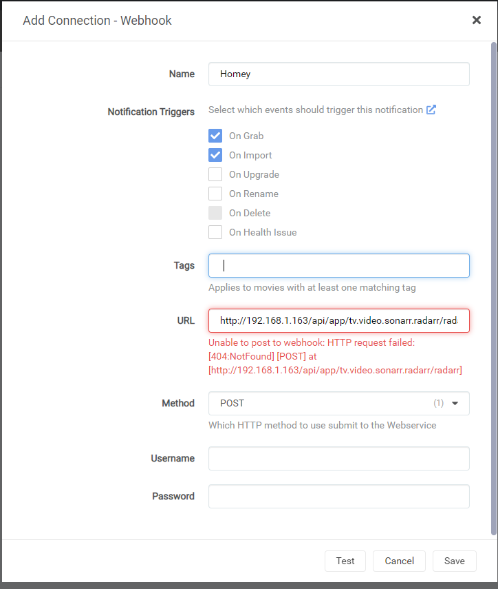

Just started to use Radarr, works great. However, I need to use a specific version of Radarr which is based on 3.0.1.2022. I cannot setup the Webbhook, if I press “Test” I get the green check mark, but when I press save, I get the red exclamation mark (but no error message):
Well, yes, you are correct. But I’m forced to run this specific version of Radarr since it incorporates the possibility to use AirDC as indexer and download client.
The webhook functionality is there, even in my old release, so I was hoping it could work anyway
At the time that i had that problem i was running version 4.
The app is updated for version 4.
I think that why it’s not working anymore for version 3. (but i am not a developer of this app)
