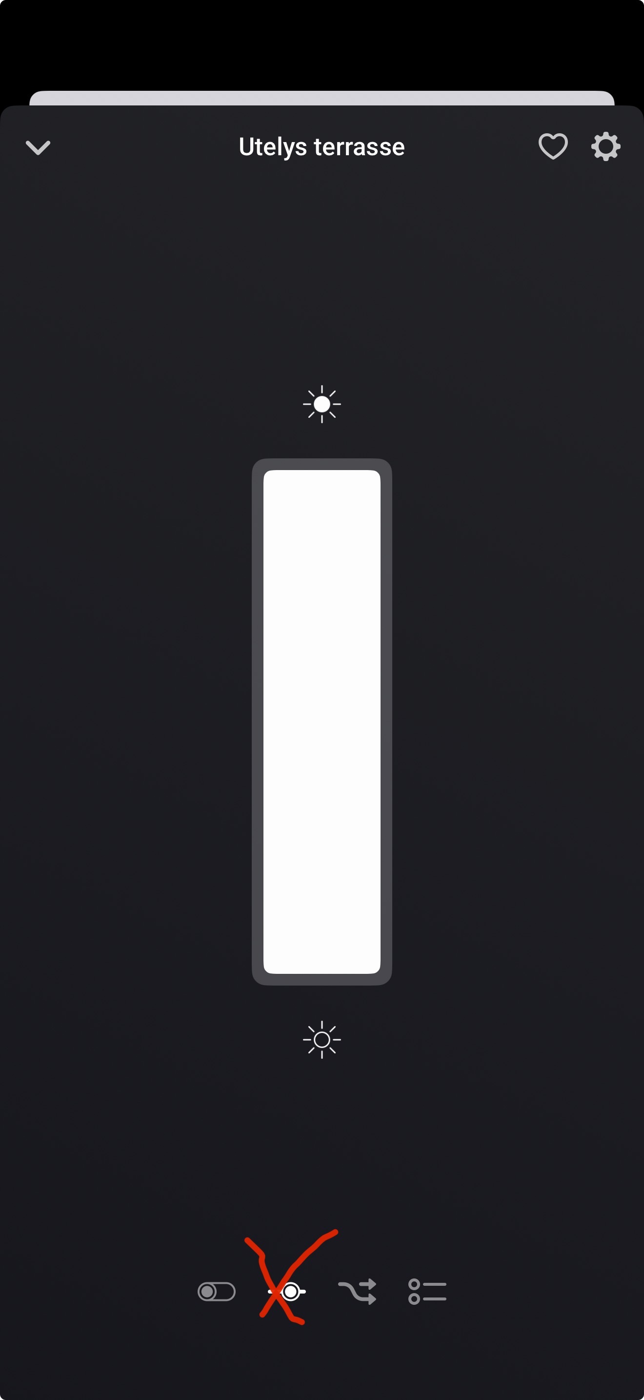

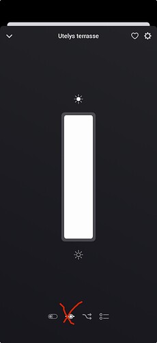

The only command I need visible is on and off. No dimming. The concept is quite easy and the specs for the dimmer relay is posted in the very first post.
In essence, all I need is an advanced setting that can be accessed in the top right corner of this control panel to remove this option from the control panel associated with the lights controlled with that relay:
Expected outcome: turning the lights off and on. That option can be accessed on the left hand side of the red X. And one option to REMOVE the dimming panel with the settings option on that Zigbee controller by accessing the settings icon in the top right corner.
