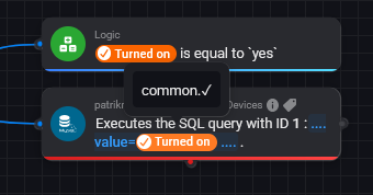

It looks like this. If I use Turned on as a AND-logic card, the value is present. But if I use it in a (fake here) MySQL statement it fails:

So in the flow, the logic card is still Yes (correct) but in the SQL and Log it is interpreted as a checkmark (and common.checkmark in the flow).

I’ve seen it before, the boolean states true and false (or yes and no) popping up as emojis :check_mark: and :cross_mark: outside of boolean variables.
I think only Athom could explain what’s going on.
I’m clueless why (on earth) and how these values turn into unusable emoji’s.
Yeah, I think you’re right, right now I have to recreate all flows that uses booleans in other card-types than direct Logic-cards. :frowning:

This tag is from an actual boolean variable;
That’s what this thread is all about.
Between HP2019 and HP2023, Athom has changed the value that represents true and false in Boolean variables from the strings true/false to the symbols ✓/⨯, breaking scripts and flows that depend on these values.
