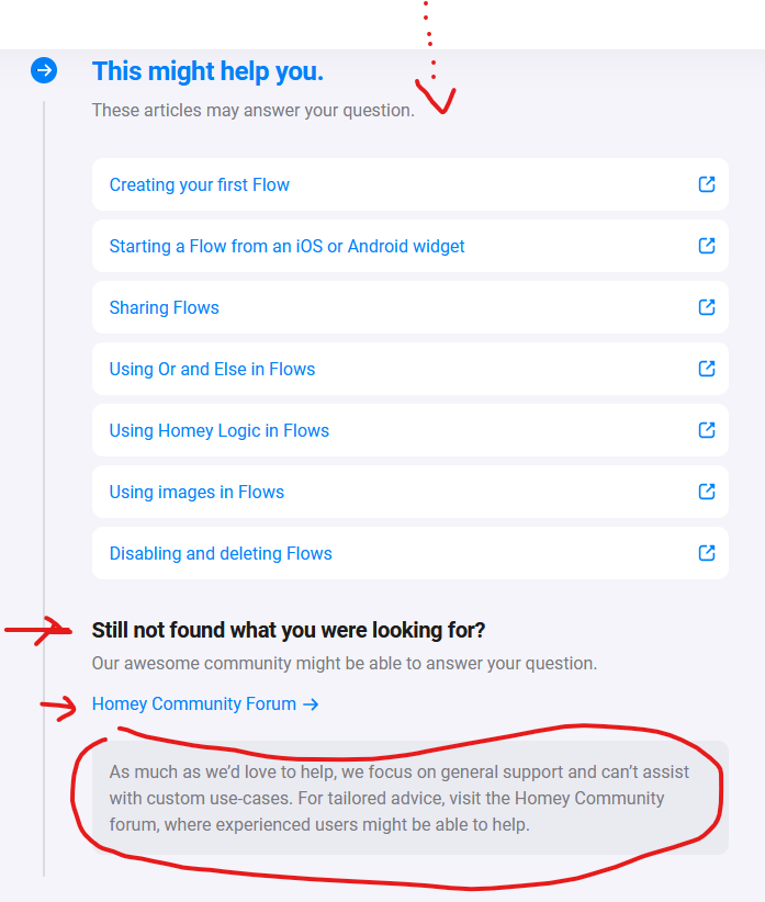

https://homey.app/support
Hi, when I select Homey Pro 2023 and then flows or logic then I get this:
So, no direct support unfortunately :frowning:

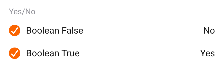

This has nothing to do with migrating, as it also happens for me (and I never migrated anything):
To make things more inconsistent, in the Variables menu, the values are shown as “Yes” and “No”:
