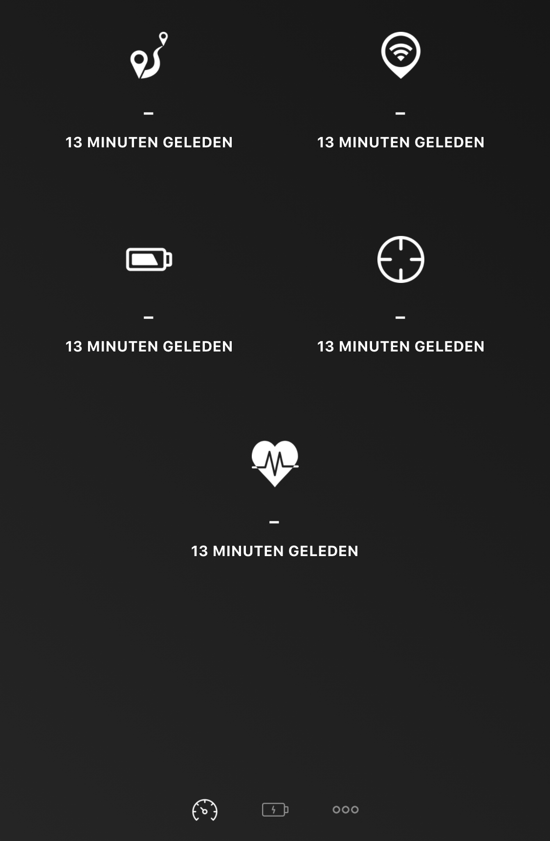

Now we maybe need to wait for a change to see some values or?image
You need to be sure that you have filled in your Apple account and password in the app settings. Syncing time can be set on 1 minute. In the logging tab you can check if everything goes well. In this case the device button must be updated after 1 minute. Ps I did not test it on apple watch. But I assume that this works also.
