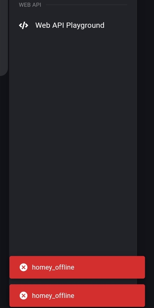

Developer Tools: Error message [object Object] when entering the Zigbee and Z-Wave page
Does anyone know what this means?

I got these messages too
For f.i. the zigbee overview, it then only shows device 0 Homey
Only after a manually refresh all my zigbee devices are listed again.
In the mobile app “Homey offline” notifications are very, very rare;
so Homey isn’t really offline, or does it suddenly respond not quick enough?

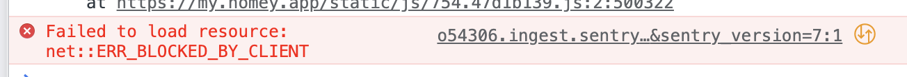

I checked the developers console but don’t see a similar error you have (http://ip.homey.homeylocal.com/), but do see this error:
I had a problem loading the web page of Homey. So I disabled Pi-Hole for 30 seconds, and than it loaded without an issue.
I googled on “Pi-Hole & ingest.sentry” and found a discussion that suggest this domein should not be blocked.
What do you guys think?
ERR_BLOCKED_BY_CLIENT suggests that you’re using an ad blocker in your browser which is blocking the request. I get the same message (also using an ad blocker) and don’t have issues with the page not loading.
It happens sometimes… So I guess more is happening. This error must have been there longer, and the Homey page loaded without issues. Only now I seem to have this issue occasionally.
The only add-blocker is Pi-Hole.
