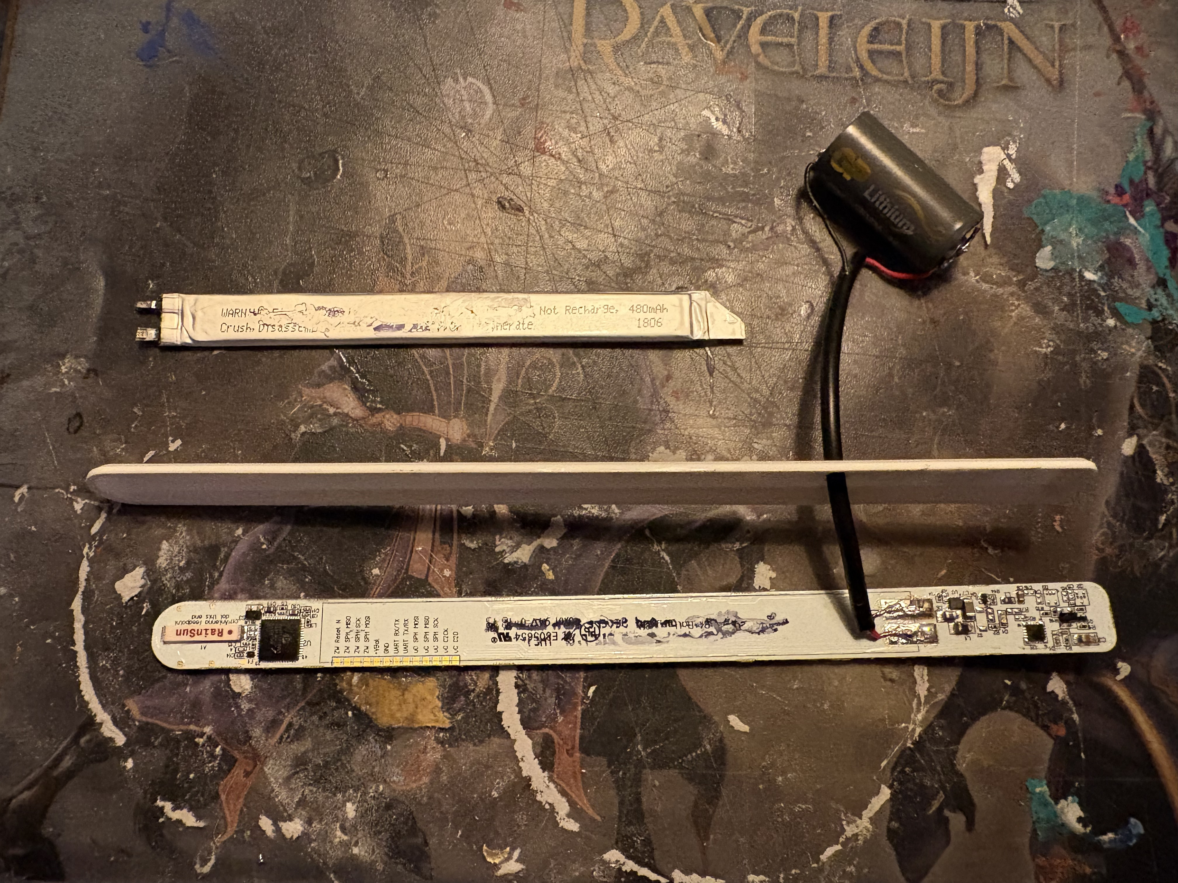

The battery in my Sensative Guard door sensor failed after three years. Since I no longer have the receipt, I decided to open the device to see if the battery can be replaced.
Opening the unit is a straightforward yet delicate process. The positive and negative terminals are clearly marked on the circuit board. See picture below:
After the replacement, I extended the cable to enable a concealed installation.
Soldering the wires directly to the battery is not ideal; however, it is necessary. Using a battery holder would increase the overall size and prevent a hidden installation.
The replacement CR123A 3V battery has a capacity of 1500 mAh. Compared to the original 480 mAh battery, this should result in a significantly longer service life.
