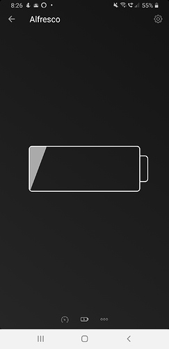

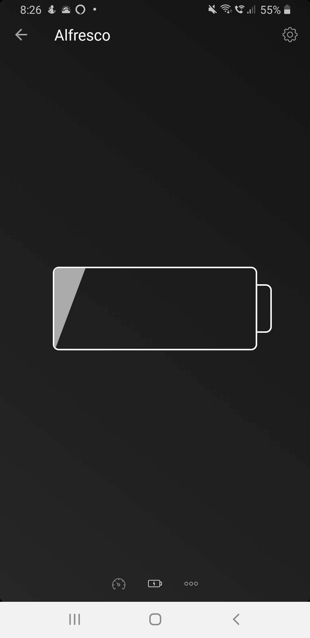

I was in my Heimdell app settings and noticed that the battery life was showing on all all sensors. I did just charge them all to 100% which was showing. I could possibly monitor that see of it changes.
I have the problem that my door/window sensor 7 and my WallMote Quad have been displaying 100% for months. Maybe it is not comparable with your problems.
