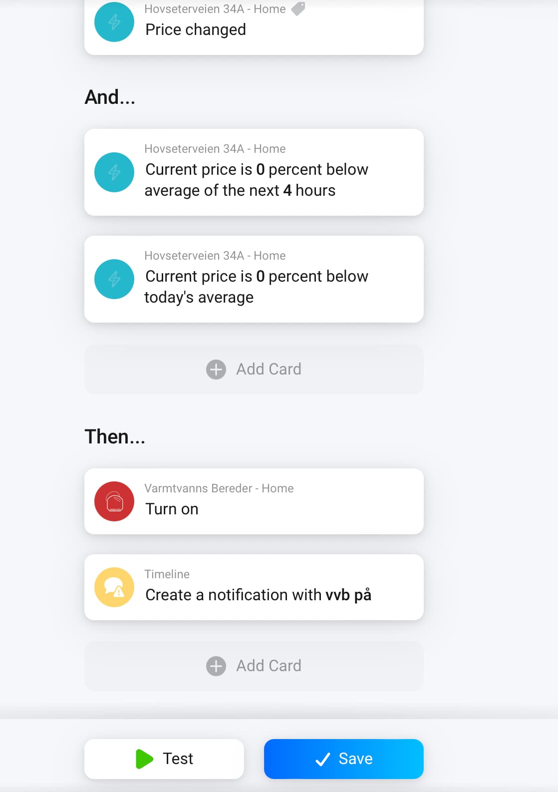

I have had success with the following rule. I’ve had it running for about a month, and overall it has worked well.
The “0 percent below average of the next 4 hours” ensures that the heater will kick in often enough, but at non-peak hours (may not be the absolute lowest of the day). The additional “0 percent below today’s average” makes sure that the heater shuts off when the price is above the average.
I experimented a bit with the “0 percent below average of the next N hours”, but found that 4 hours worked well.

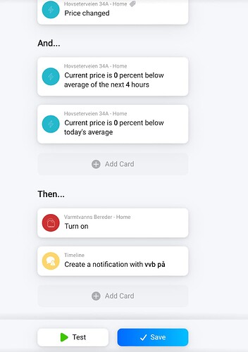

Hi, thanks for the response. I managed to recreate this flow, except for the final part with the else card.
I do not have that part of the flow. How do I get it?
currently my flow looks like this:
and I can’t create the card to shut of the heater unless the criteria are met…
You need to :
  1. “Add card” > “Turn off”
  2. When the “Turn off” card appears under “Then…”, tap and hold the card. You can then drag it downwards, and the “Else” should appear. You can then drag and drop it under “Else…”
It’s a bit of a “hidden” functionality…
Thanks :slight_smile: that sorted it out perfectly :slight_smile:

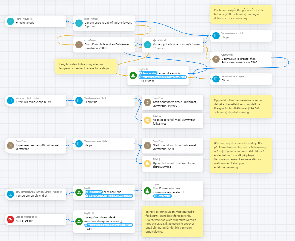

Here is an example flow. Unfortunately the comments are in Norwegian.
