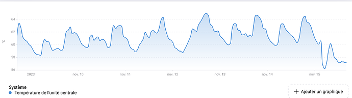

Since the first day of setting up my Homey 2023, I have noticed that the temperature fluctuates between 58 degrees and 65 degrees. Could you tell me if you are experiencing similar results at your place? I have the impression that it is heating up a lot.
Thank you.
There is dedicated thread,where this is being discussed and some DIY solutions applied. However quick answer - yes, unfortunately it’s normal, critical is 85 °C
Okay, thank you. I thought there was an issue, and I was ready to get some fans. So, if it’s normal, I assume the designers have conducted extensive tests to prevent any component degradation, and there’s no need to be alarmed.
