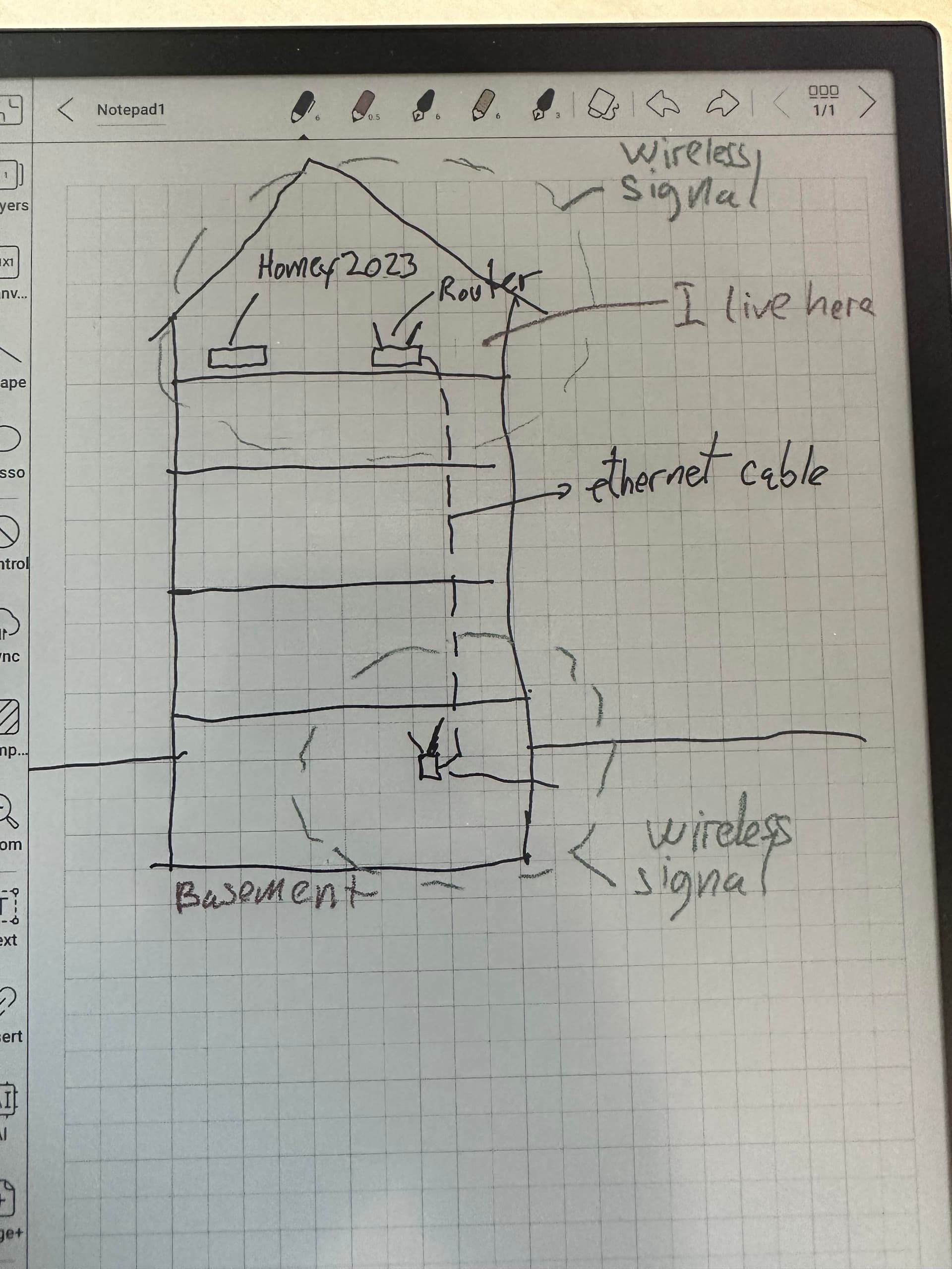

Below is the sketch of the scenario

Your best bet is to use WiFi devices, Zigbee doesn’t work over cables so any devices need to be “in sight” of either Homey, or Zigbee routers in Homey’s Zigbee network.
As long as the WiFi router/extended in the basement is in the same local network as Homey (and provided the WiFi devices you want to add are supported), it should work.
Thank you sir!! Perfect
